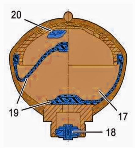

The saucer spheres on the C5s have a spike(s) on the inside of the sphere above the membrane. The sphere has a safety pre-form in its upper part. In the event of bursting through overpressure, the pre-form prevents projections of metal pieces.
to avoid the possibility of the sphere bursting. When that happens - there is no gas so no springing apart from the air in your tyres! So as you had it diagnosed at the dealer - Diagbox would of told them if the height correctors were functioning or not - so their advice on your spheres may be correct.
I've had no experience of aftermarket spheres - and would only fit originals. The saucer spheres are not supposed to be re-gassed officially either - so if these spheres are reconditioned ones - I would avoid.
That would mean that the BHI is functioning properly.
So that leaves either air locks in the system - (did you bleed the system after replacing the spheres last time?) or possibly the spheres are shot - burst, punctured - but in either case without nitrogen. I have to ask - but is it possible you over filled the LDS tank - or didn't have it on the lowest setting when checking levels last time?
| Reference | Designation |
| 17 | Suspension sphere (slimline type) |
| 18 | Suspension damper |
| 19 | Diaphragm |
| 20 | Safety break point |
