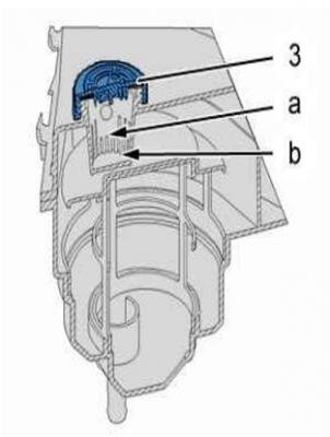

If the fronts have gone rock hard again then suspect air in the system, knackered / ruptured spheres, low LDS level, BHI (valve block possibly). Does the car raise and lower on command through all the height settings? Or is the right just a little firmer than normal - there's a big difference. If the height is raising and lowering, then the valves in the hydraulic block would appear to operating correctly. If this is so, that would still point to air in the system most likely or ruptured / incorrect spheres.
Were these sphere replacements for your MK II C5? and if so what pressures / volume of spheres did you get?
Follow the bleeding procedure again - make sure it is on the low setting when bleeding as per the instructions and make sure the wheel is turned very slowly lock to lock as specified.
For your MK II 2.2 C5 the LDs levels should be between 'a' & 'b' marks
