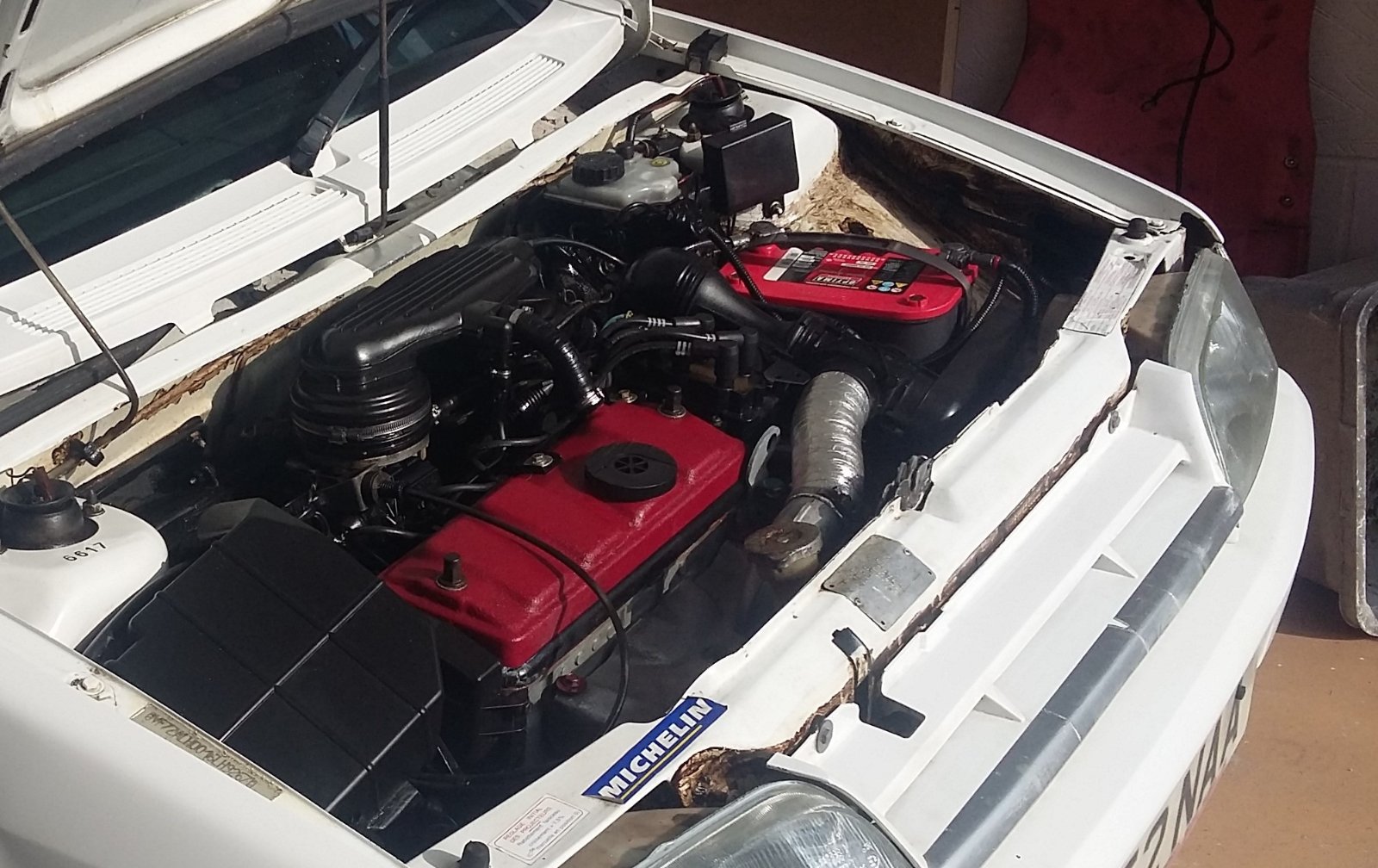

(Brown seams is Bilt&Hamber protective wax:
I use a light spray with diesel or a very light oil for cruddy-oily build up, wooden stirring sticks from Macdonald's (cut to a point) to clean out corners the Paraffin or terps on rags (so as not to wash oils out of seams) with these wrapped around various "sticks" to enable me to get in under non-removalble parts and hard to reach areas. Swarfega is great as you can use it on rags or a brush to clean off all the oil residue.
Biggest hints....Remove everything you can including battery trays, inlet pipes, air-clearer box etc, it is quicker and also gives a better result. Wash all plastic using Swarfega rather than a detergent liquid. (The gritty stuff is not good for this)
I try never to use any "powered jet" of water (Anything slightly modern I would strongly advise against it) .....using small sticks and rags you will get just as good a clean and will not wash out the protective oils in the seams.
