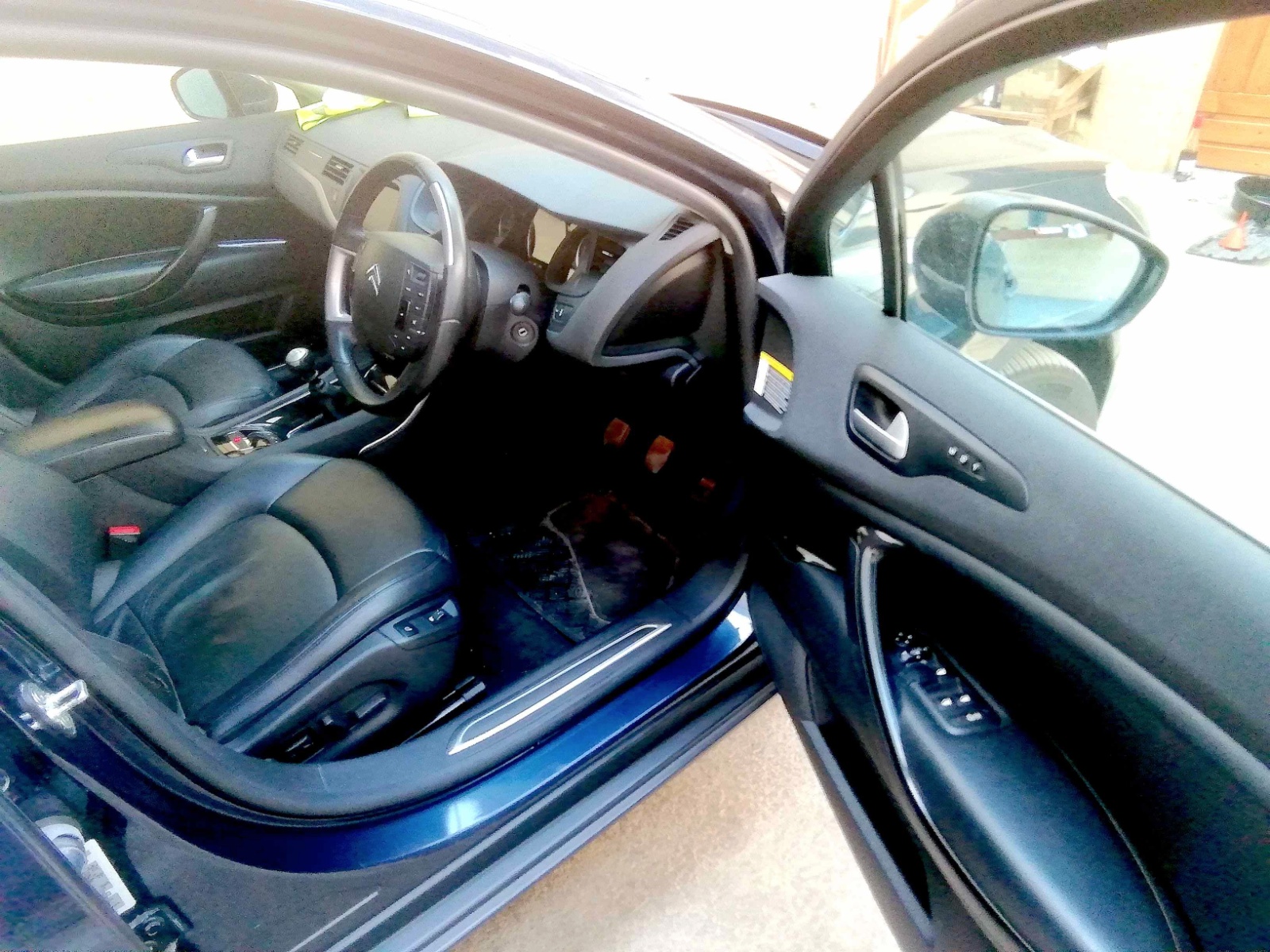

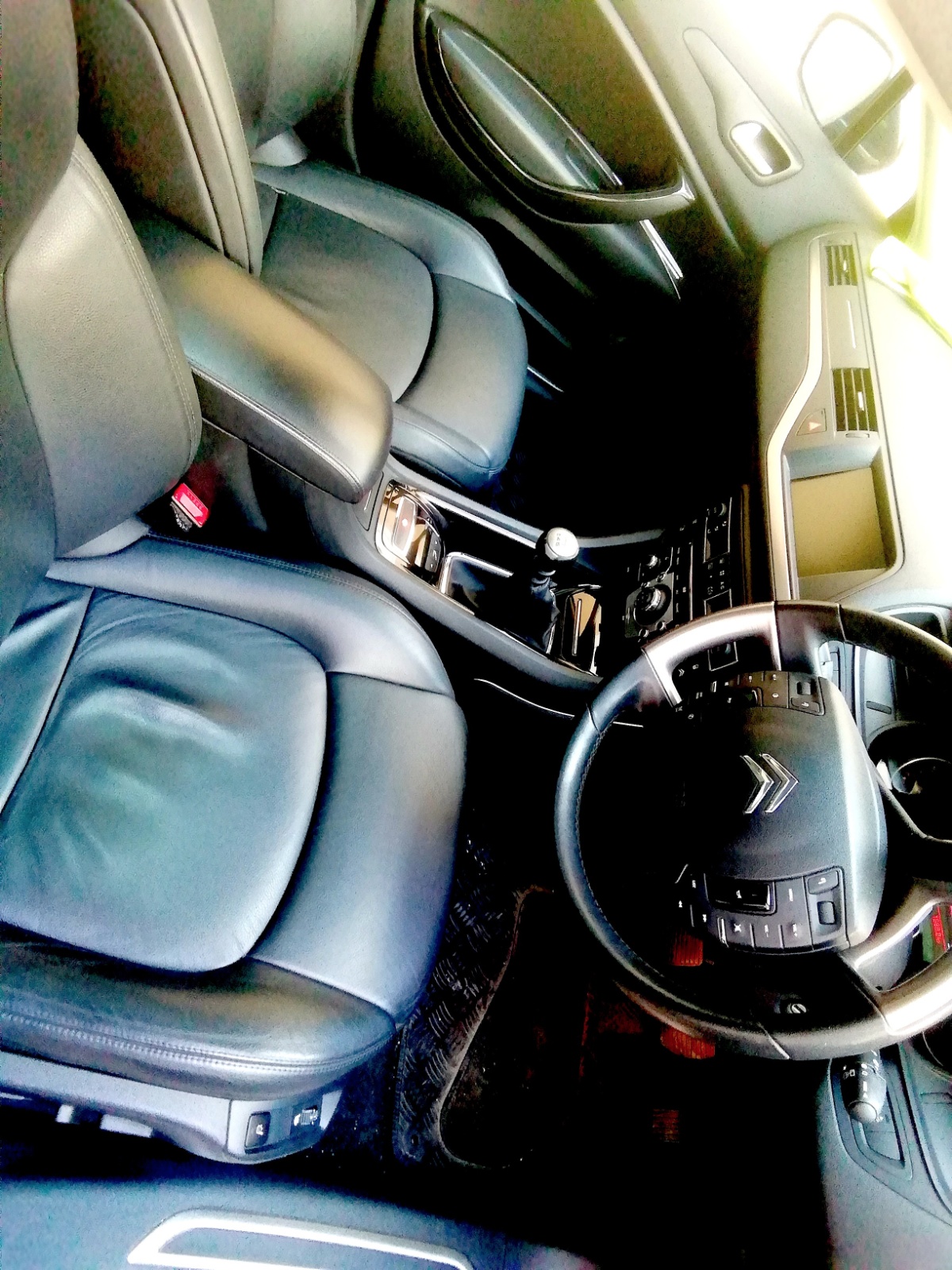

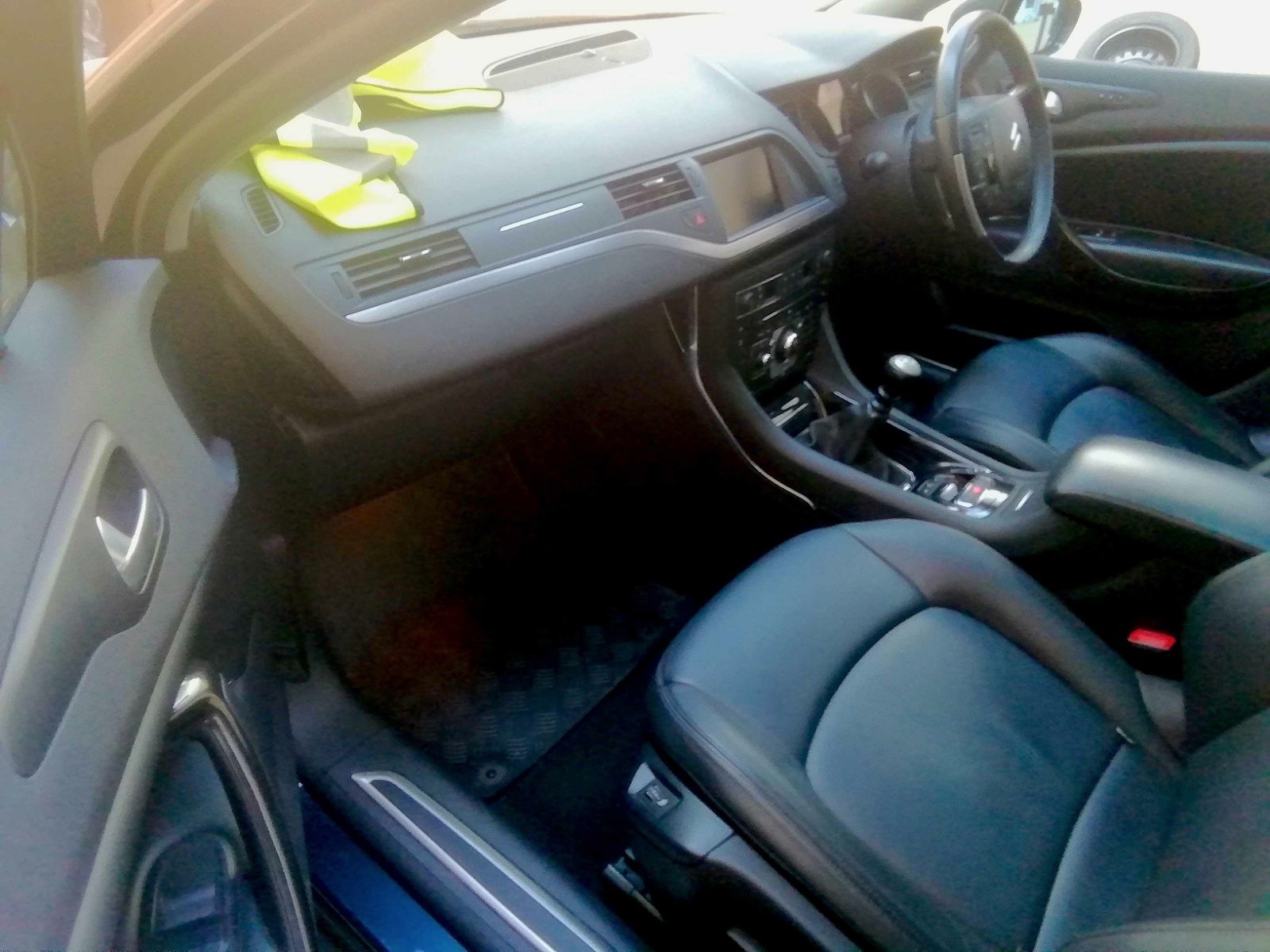

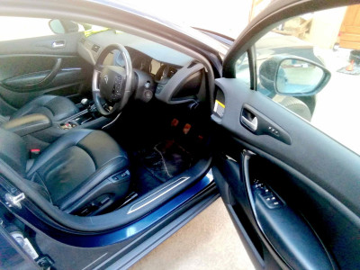

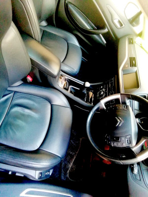

Blimey, this seems like a million miles away now since the fixes went into my X7 '09. Great car, and although I usually admire it each night while sitting in the courtyard for a few minutes, its just a tool to me ultimately. Oh dear; does that suggest I may be getting past it then… such wonderful creations being mere 'tools'…
Anyhow, glad you`re managing to find your way around issues to bring it up to scratch, Peter, once they`re running well they`re dream cars, excellent in fact. Of course, this means tomorrow morning I may find a puddle of oil under the front wheels and a non-starter and then think otherwise. Or worse, down the nether regions as yet unexplored.
On the economy front I just wouldn`t know, other than coming from a 10MPG V8LR (though most of the time on LPG which is usually not available here) and being mighty pleased when the fuel gauge after top-up on best diesel says in précis….'You have 1350 kms to go before needing a refill'. That`s good enough for me.
So its all going well here with the X7 after the 3-4 weeks work required, I listen to everything, the suspension which over some ground going slow does …I don`t know… `a slight pop and gurgle`, almost inaudible, but other than that nothing. I did flush the oil again, but with no Castrol Edge to pick up locally I replenished with C2 stuff again. 'Old stuff' had only done 200km max.
I noticed someones post earlier about an interior for yours Peter, and you questioning the seat connections which Marc explained. Well, here`s my front interior which I enjoy when opening the door most days (the rear appears like new)…. Almost makes me want to go and get more DIY materials EVERY day just for the pleasure of getting in there, and switch on the AC too of course.
