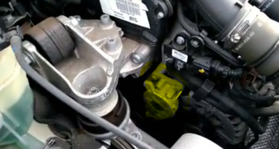

Re: 508 initial cold revving sounds awful
Nothing of note in the engine bay other than it can be heard better.

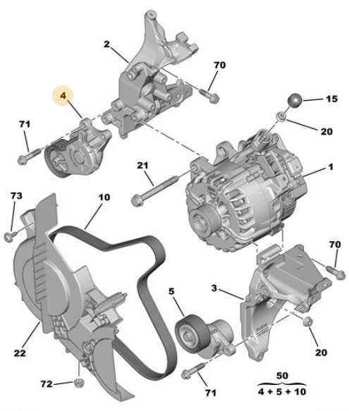

Ok, so from your video - although you were whizzing about a bit quick, it certainly looked like the Dynamic tensioner roller - I may be mistaken, but it did seem to rattle in unison - I've marked it in yellow:
and below is the part - item (4). You have a reversible alternator on the vehicle. I know there was another member who had an issue with his - let me try and find it....
