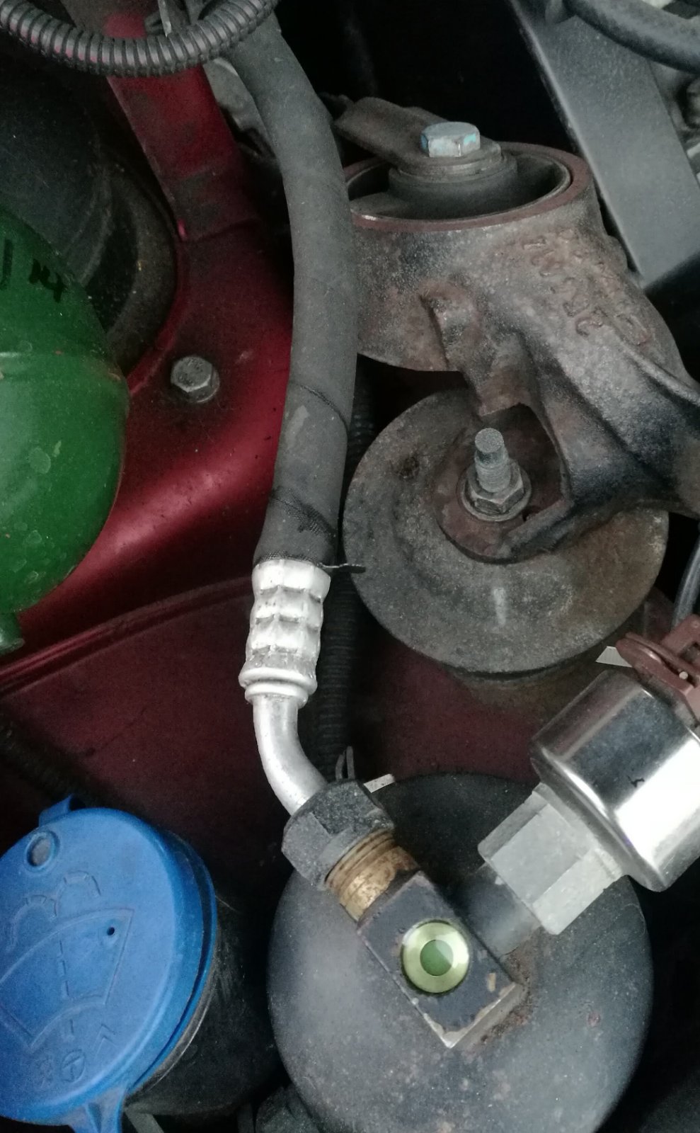

The good thing is that I know where the leaks are. Assuming there are none hiding actually on the evaporator anyway.
One of them is dead easy. Leaky Schrader core on the LP service port. That's a five minute job to change - and I think I might even still have the core changing tool floating around somewhere so I can do that myself.
The second leak however is a little more troublesome. The crimped join between the rigid pipe and flexible hose on the pipe running between the accumulator and evaporator has failed.
Wider angle to better show the location.

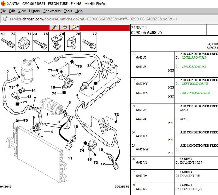

That end is nice and accessible...but the other end vanishes into the bowels of the engine bay behind the engine. I've a horrible feeling it may well run all the way to the TXV on the evaporator (assuming it has one...do automotive systems use a TXV or cap tube usually?) which would mean it's a dash out job to change. Anyone got a diagram?
Given that replacing the whole line looks to involve taking the whole car apart, is there My reason the rigid line couldn't be cut and a new flexible line be made then attached using compression fittings?

I am pretty sure that the Xantia TXV is on the engine side of the bulkhead, probably below the LHM tank.

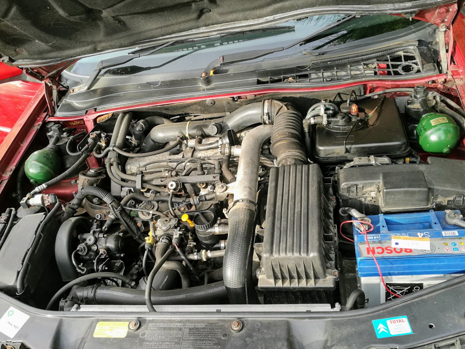

- Posts: 11769
- Joined: 28 Mar 2013, 21:05
- x 1982
Re: Xantia Activa AC Liquid Line Replacement
2"ltr XUD type...they all look similar.

Pretty sure the accumulator is in a different location on the TD - on my first Xantia (admittedly an S2 car) it was directly behind the O/S headlight - I remember hurling curses at it when changing the bulbs.
Either way... it's shown as NFP exactly as I expected. If that's for the TD, even less likely not still be available for the TCT given there are probably an order of magnitude XUD/DW engined cars left...
What's more worrying though is it looks like both of those lines are part of one assembly, joined together at the bulkhead if the diagram is right...in which case yes, chopping things up and getting inventive is very much more likely to become necessary.

Although there were several variants of the A/C pipes, I expect that the version you need was used on more than the TCT.
I have on several occasions had A/C hoses for classic cars remade with new flexible sections fitted to old metal ends. The trick is finding someone with the correct crimping tools and the expertise to get everything aligned properly.
Also note that there is a join in the low pressure line from the evaporator to the compressor, which is quite tricky to undo without damage, and (according to Citroen) on good for a few connection cycles before both halves of the pipe must be replaced.
