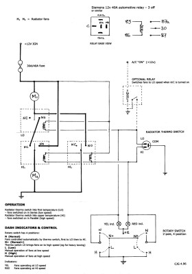

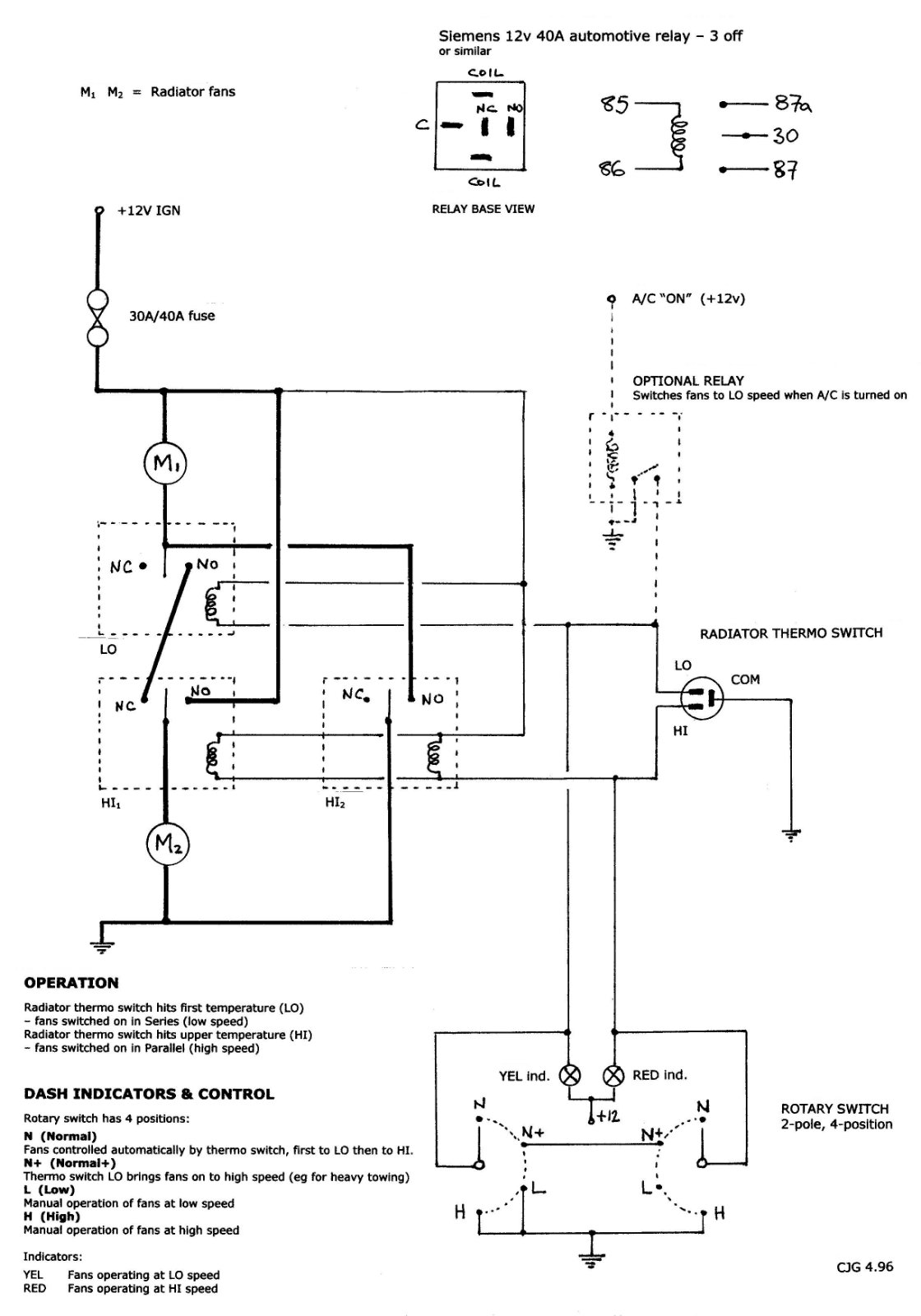

Here's the standard circuit set-up for twin fans being controlled by the bank of three relays. The relays are energised by supplies from either a two-stage thermo-switch (early models) or from an ECU-fed temperature controller* (later models).
* Check polarity of this control signal, +12 or Gnd.
Either way, it is possible to manually turn on the relays (you just need to identify the Low and High speed supply lines) to give manual switching of the fans.
The circuit was originally drawn to add manual fan control to a twin-fan BX.
Hope the circuit may be of use.

So when I find the low and high speed power lines do i splice these to a rocker switch for the manual operation of one or both ?
If that makes sence.
:-D
x 1751
Re: Citroen zx radiator fan to manual switching.
Locate the Hi and Lo signal lines, and check whether they are +12 or Gnd when fans go into operation.
Splice into those for the manual switch(es).
I don't have a ZX wiring diagram handy, but someone here might well have one.
Caution: don't modify/change the connections to the main relay contacts, as the three relays are inter-connected, and if this is done incorrectly there is a risk of a high-current short circuit.

Update,
Things seem to be fine , I unplugged the sensor on the top right side of radiator and bridge the plug and added a toggle switch correct ampage, so far I've only used it 3 times only when idling in traffic cues , watch the needle flick switch if need be.
Today I will plug it back to the sensor and see what happens .... The little saga continues
