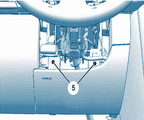

It's not the driver's airbag - that is contained in the steering wheel. The one being referred to is the driver's knee airbag in the steering column as fitted to the 207 on some trim levels.
If fitted, this is where it is located behind this panelOnce the trim is removed, this is the module
on the underside.

ah, that is great information, thanks. But then it throws the confusion of the fact I dont have an airbag there and the car never has had one! Any ideas?
x 6954
Re: Peugeot 207 Airbag faults (open circuit, coherence fault)
You need to pop up your VIN so I can check some other information. I suspect that the Airbag ECU is not happy about your wiring - and may be giving conflicting information

Strangely, I went through everything again, and changed nothing as far as I was aware. I redid Peugeot Planet and made the steering column airbag as showing as absent again, and then it no has got rid of the fault (fingers crossed, but it drove fine for an hour). Thanks for all your help
x 6954
It should be absent - if you don't have it installed and the ECU is configured incorrectly it will throw the system out.
