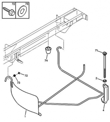

I need the nylon washer/Bush that goes on this and sits in the recess in the boot.
Does anybody know where I can get one from or have one for sale.
Also, I'm looking at making a new hanger bolt out of threaded rod (mine isn't seized, just a pain.to undo)
Does anybody have the length and thickness of the said hanger??
As per. Any info would be greatly appreciated..

Contrary to the above - these parts are all showing as available from Citroen. It always pays to ask
The wheel carrier (1) part 7603J5: £106.37
The washer (2) part 761554 £0.82
The Spare wheel support Hook (4) part 761571 £19.78
The spare wheel support fix screw (71) (223mm long) part 7615A4 £8.86
The buffer (74) part 698349 (27mm) £22.51
All the above inc. VAT

You can order them from any Citroen dealer via the phone - you have the part numbers I have given you. Or use these part numbers see if you can find any on the aftermarket. Normally if these are no longer supplied or available they will mark them as such - but all these are showing as available.
