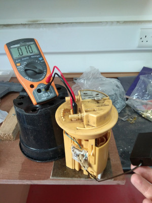

Has anyone had the fuel gauge intermittently dropping the signal and flashing the orange light - then a few minutes later returning to correct tank level?

Re: 2.0HDI hunting at idle
Probably a sticking contact wire on the sender
See my post here for a picture example - you have a pump and sender on your car, but the one in the post link below with pics is a sender only - no pump, but still gives you an indication of where the wire can become detached giving erratic readings...
viewtopic.php?f=53&t=62630&hilit=sender#p609032
So bear in mind it's not the same unit as yours.
Only getting around to this now. The wire looks okay. Should I just resolder it to ensure the contract is correct? The tracks for the potentiometer look to be well worn, could they actually be the problem?
Also what is this filter at the bottom and should this gum be covering it partially?
That looks suspiciously like the gloop that grows in diesel.
What is that thing anyway?
- x 6956
Can't speak for 'the blob' and I have no electrical diagram for the system on this vehicle, but the track does look worn and if it's not making good contact, then obviously readings will be erratic.
Part number for the pump with gauge is 1525T4 £59 inc postage for a new VDO one:
https://www.ebay.co.uk/p/VDO-CITROEN-XS ... 2043718202
I'm guessing that it is the inlet for the pump as there is no other inlet on the bottom.
To repair the tracks I think I'll get a PCB trace repair pen and fix it that way.
Repaired the track with solder. Readings from the gauge now correct again.
- x 6956
Well done, I hope the solder is flat and smooth or it may wear the contactor, - but at least the pumps are not expensive to replace if needed.
Yeah it's smooth, but I'll go over it with some wet and dry before installing.
Is there any special additive that I can add to the tank to dissolve that gunk? I'm sure there will be more of that crap in the tank so rather than it clogging the filter again I'd try to get rid of it now.
