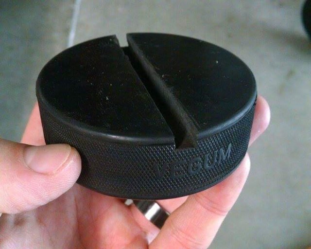

Can't advise on jacking points but it may be worth investing in some of these:
Jack Puck
Jack Puck
Give a little extra height and help protect the sills.
I snagged a pair for about a fiver, watch what you pay, one firm (SGS IIRC) wanted £500 each for them. Hopefully a pricing error.
