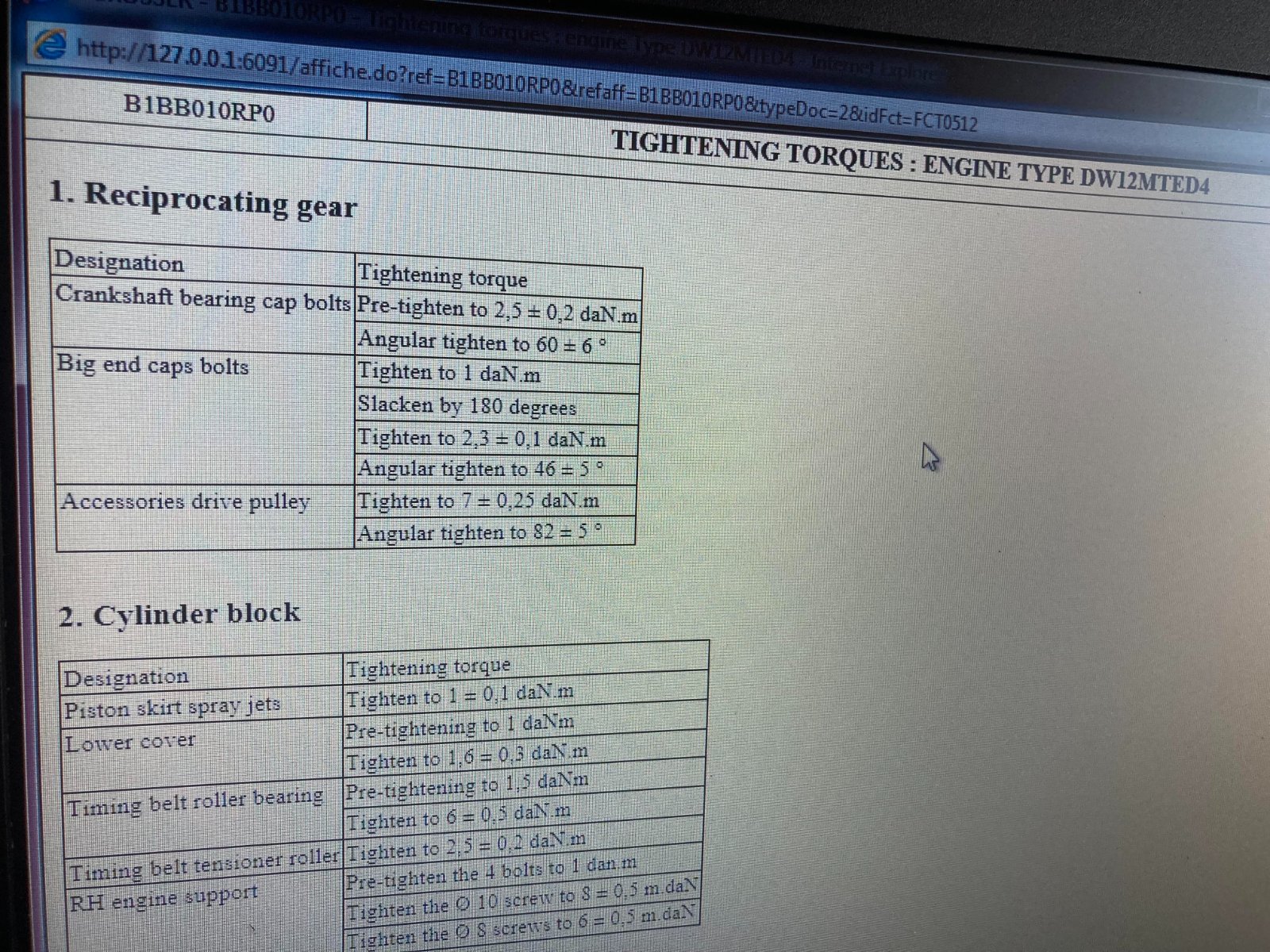

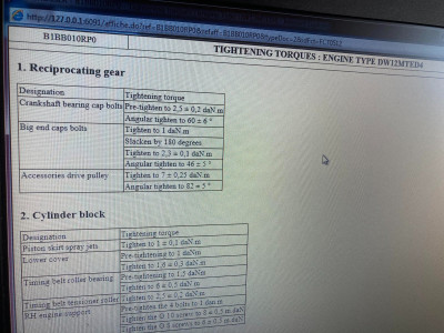

Can anyone help i can't find the torque specification on the con rod and big end bearings
Steve Walsh
- Posts: 767
- Joined: 25 Oct 2019, 07:20
- x 512
Re: C crosser help
I put this on your post yesterday.
