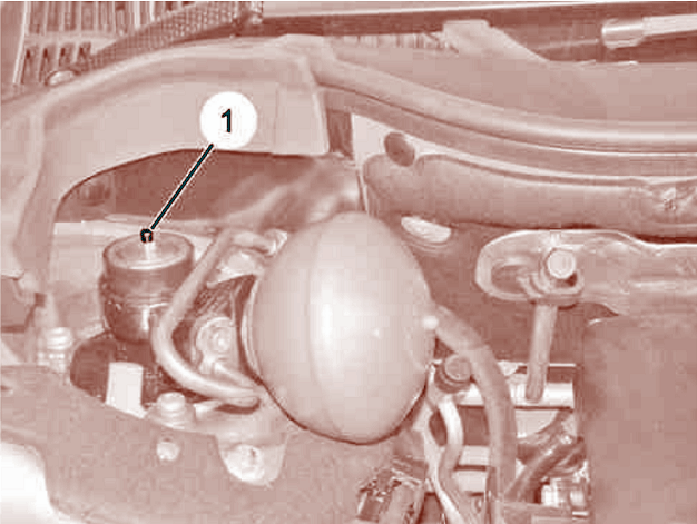

- x 6961
Re: Citroen C5 suspension fault rises but then not level on unever ground
Andy - here is the manual method:
Place a hose on the pressure release screw (1).
Gradually unscrew the pressure release screw (1).
Wait for the pressure in the hydraulic circuit to fall fully.
