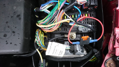

Hi all
My 2005 C4 has been giving me a kicking again :(
I am 99% sure i now need a replacement engine fusebox just not sure which one i need so any help appreciated :)

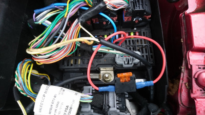

I have already done the blower bridge ( not shown in pics) but the pictures show the fusebox before that bridge ( 15 months ago) :)
Something i did not pick up on was the fact that the inline 40 amp fuse is actually replacing fuse #13 the BSM :(
Well it has now melted that fuse and the connectors to the fuse holder are burnt black. I replaced the wiring and fitted a new inline fuse and even after a BSI reset i am getting strange faults, brake lights on all the time, wiggle the connector and brake lights off, air bag lights on and when it starts foot on brake pedal display goes blank and engine cuts out.Wiggle connectors so brake lights stay on and runs fine, except foot on brake pedal and wipers come on lol
I can talk to the car with my clone Lexia but only via Diagbox which detects Vin but will not talk to all ECU etc, Lexia3 is other option but i need to input RPO number and i do not know where to find that, thought it was on sticker on drivers door pillar but needs to be a 5 digit number and cannot find one there ?
And is a replacement BSM as Citroen call it a plug and play or something above my pay grade :oops:
As always putting my faith in your capable hands to stop SWMBO going into a mega rage :rofl2:

Part is 6500CK Colin. It doesn’t need coding or programming, but make sure you follow the battery disconnection and reconnection Procedure.

Re: C4 engine fusebox help needed
Unread post by admiral51 »
Thanks Marc any ideas what a new one costs from Citroen, 2nd hand is going to be risky as it is a 14 yr old car, not going to waste good money, would like to get a new one and then chase back the wiring bypass issues :)

Hi Colin, your RPO is located on the driver door pillar where the tyre pressures are. Ignore the letters, just the numbers, and in your case your RPO is: 10371. Lexia is fine for your C4 as it's a 2005 model.
Part 6500CK is currently £290.14 inc. VAT from Citroen, although Eurocarcare have new ones in for £162 inc. VAT plus shipping:
https://www.eurocarcare.net/bulbs-fuses ... e-box.html

Thanks Marc ordered from the link hopefully it will sort the issue out

Talk about good service ordered part yesterday at 10 am arrived this morning at 9 am .
Fitted in under 20 minutes, BSI reset procedure followed and every thing works as it should :)
Taken fuse out from the heater blower bridge wire and it actually works as Citroen intended, no longer need to switch blower off before turning ignition on :lol:
I paid £170 ish for it all in, main dealers wanted just shy of £300 and when removed it had something rattling around in it.
Car has also been in for service at my local garage, £400 for oil/fuel/air and pollen filter, oil change and brake fluid change plus replacement of the near side inner steering rack joint that had been flagged as advisory for 4+ years on the MOT :)
Fuse box issue in first post happened 6 days ago, 2 days before it was due for its service so no fault of the garage, just hoped my re wiring had solved the problem but have a very happy SWMBO right now so thanks for all your help.
