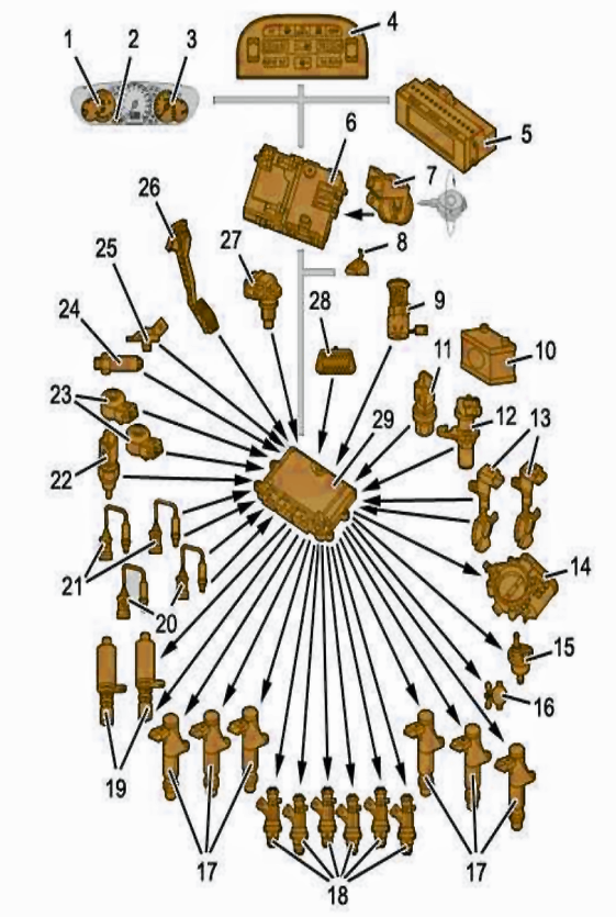

You're going to kick yourself - the reason you can't find it is because it's in the fuel tank! :rofl2:

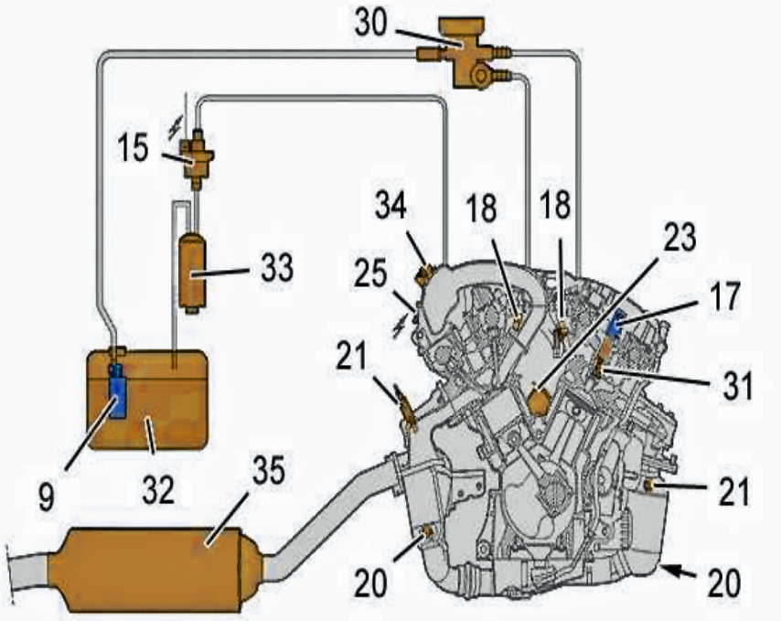

Here's the components of the fuel system for reference (Bosch ME 7.4.7) It's item (9) on the diagram.
Click Image to Zoom
(1) Fuel consumption data.
(2) Injection ignition test warning lamp.
(3) tachometer.
(4) Air conditioning ECU.
(5) multifunction screen.
(6) Built-in systems interface .
(7) Transponder .
(8) Automatic gearbox ECU .
(9) Pump, fuel filter and pressure regulator assembly (except grande exportation).
(10) Battery .
(11) pressostat.
(12) Engine speed sensor .
(13) The camshaft position sensor (x2).
(14) Motorised throttle housing .
(15) canister discharge electrovalve.
(16) electric cooling fan unit.
(17) Pencil type sparking plug (x6).
(18) Petrol injector (x6).
(19) Variable timing electrovalve (x2).
(20) Downstream oxygen sensor (x2).
(21) Upstream oxygen sensor (x2).
(22) Engine coolant temperature sensor .
(23) Knock sensor (x2).
(24) Power steering pressure sensor .
(25) Integral pressure sensor.
(26) Accelerator pedal position sensor.
(27) Air temperature sensor .
(28) Diagnostic connector .
(29) ignition injection control unit.
(30) Pulsation damper.
(31) Spark plugs (x6).
(32) Fuel tank.
(33) Canister reservoir.
(34) Pressure relief valve.
(35) Exhaust system.
It's a combined Pump, Fuel Filter and Pressure Regulator Assembly, made by Marwall.
So it's submerged in the tank, operates on 12V, with a pressure of 3 Bars, has a Flow rate of 115 to 120 l/h and the regulation pressure is 3.5 bars.
