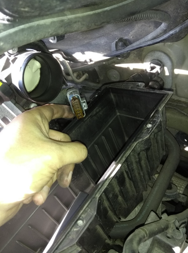

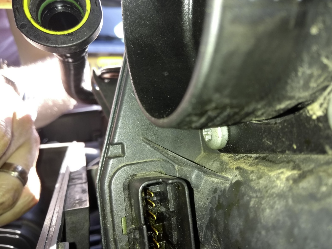

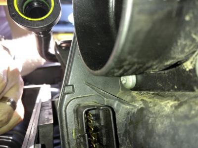

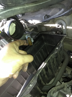

Hello,
I'm new here, although I've owned Citroens for many years (but not with so much electronics as this one...)
I'm hoping someone may be able to help with a tricky problem my Picasso has been having. It's a 2007 1.6 16V TU5JP4. Has anyone come across (with Picasso or other Cits/Peugeots with this engine) a problem with oil entering the throttle body plug? I unplugged the connector earlier while troubleshooting troublesome fuel system faults and found a significant amount of oil. It has presumably made its way there from the crankcase breather hose attached to the airbox next to the throttle body, and has been messing with the operation of the motorised throttle/ position sensing/idle control and possibly the iat sensor. This I believe has been the cause of engine choking issues (super high fuel trim), hesitation, intermittent driveability issues etc.
I've cleaned up the oil using switch cleaner and cotton buds, and after reassembling and taking the car out on a few short runs, I could feel that things were very slowly getting better. I can read some live data and could tell from that also (lambda 1 and short term trim starting to cycle again, Long Term trim coming down from +24% to +13%). Hopefully some more longer drives will start to see further improvements.
Next step is how to stop oil getting to where it's not supposed to and trace if its related to issues elsewhere... My garage noticed a little oil in the lambda sensor connections and in the ECU main block... Any thoughts welcome!
Thanks,
Mark

OK, if anyone's interested it was indeed the oil pressure switch that was leaking... and because of the protective cover over it, the oil was coming through the switch body, filling the electrical connector and wicking down the wiring reaching:
Throttle control connector on throttle body: so motorised throttle, position sensing, idle control valve, IAT sensor
MAP sensor
Both lambda sensors
ECU centre plug
It's running better now - just need to keep checking connectors for oil every so often and cleaning out any I find.
I'm hoping this info might save Picasso/C4/Berlingo/Peugeot 307 etc. owners with the TU5JP4 engine a lot of money - the (long established) garage said they'd NOT seen this fault before in a Picasso. It's worth checking your oil pressure switch occasionally as you may not see any external evidence of leakage until you start getting random hesitation, EML, fault codes to do with O2 sensors/mixture control etc. Apparently it's a known issue with some small-engined petrol Corsa and Astra models around 2008, but I didn't find anything online about PSA cars - except that Peugeot 207s where washer fluid will leak into the loom and the ECU....
Kind regards,
Mark
