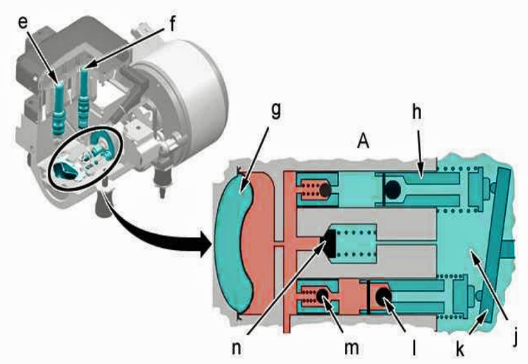

Re: Hard Ride on C5
This is the setup on these:
"A" Sectional view of the integrated hydroelectronic pump unit: 140 bars, 0,7l/min, at 2300 rpm.
"e" The suspension inlet electrovalve (Rear ).
"f" The suspension exhaust electrovalve (Rear ).
"g" Pressure accumulator.
"h" Pistons (x5).
"j" LDS fluid reservoir.
"k" Rotating plate.
"l" Vacuum valve.
"m" Delivery valve.
"n" overpressure valve (180 bars).
The front suspension inlet and exhaust solenoid valves are not shown in the above diagram.
When it turns, the plate "k" causes the movement of the pistons in their respective cylinders.
