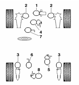

What is the functionality of the central rear sphere ?

The accumulator sphere (and the mis-named anti-sink sphere; it is actually another accumulator sphere) are there to provide a pressure reserve should you lose the pump. It is not much, but should be enough to stop the car twice from motorways speeds should the pump fail.

Depending on your model. one will be for the anti sink and the other will be an accumulator sphere for hydractive systems.
(1) Main pressure accumulator.
(2) Suspension sphere (front).
(3) Suspension sphere (rear).
(4) Hydractive suspension regulator accumulator (front).
(5) Hydractive suspension regulator accumulator (rear).
(6) SC/MAC storage battery. (Anti Sink System)
(7) SC.CAR accumulator. (Vehicles with Active Roll Control Systems only)
(8) SC.CAR regulator accumulator. (Vehicles with Active Roll Control Systems only)

If you mean the one with the pipe coming directly out of the sphere, this is the rear brake accumulator sphere often called the anti-sink sphere as it first appeared in anti-sink models.
On older Citroen's the rear suspension pressure was permanently connected to the brake doseur valve. In the event that main system pressure was catastrophically lost the front brakes would fail (except in models like the CX with an additional front brake accumulator sphere fed through a one way valve dedicated to the front brakes) however the rear brakes would continue to work by the pressure stored in the rear suspension.
Anti-sink introduced in 1994 added anti-sink valves between the height corrector/brake doseur valve and suspension struts. When the main system pressure drops below suspension pressure these valves close and isolate the suspension struts from the height correctors and brake doseur valve - this prevents the car from sinking quickly, this is because both the height corrector and brake doseur are internally leaky by design and the anti-sink valves isolate these leaky devices.
However this introduces a major safety problem - if the main system pressure disappeared due to a catastrophic failure the anti-sink valves would immediately close, isolating the rear suspension struts from the brake doseur valve, and you would lose your rear brakes as well - no redundancy.
So a rear brake accumulator sphere was added - this is connected on the brake doseur valve side of the anti-sink valve. When the system is operating normally it is effectively connected in parallel with the rear suspension spheres however as it is piped through a long small diameter pipe it does not contribute significantly to ride. It is kept at the same average pressure as the rear suspension.
If the main system pressure fails the anti-sink valves will close and now the rear brake accumulator sphere will supply the brake doseur valve and allow the rear brakes to still work.
So the purpose of the sphere is to re-instate the rear brake redundancy that was already there in the system before anti-sink was introduced. A corollary to this is that if the rear brake accumulator sphere is stuffed, should system pressure fail you will lose both front and rear brakes together...
