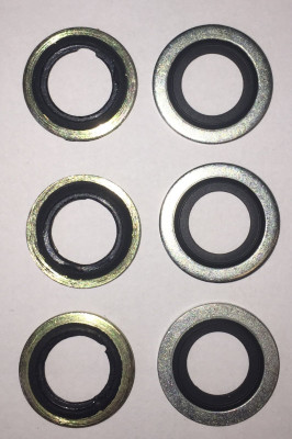

The zinc plated viton seals arrived, so I'm all set to do the oil change and replace the seals tomorrow.
The manufacturing quality of the second set is far better than the first set which I really wasn't happy with even besides the marginal temperature rating of the nitrile rubber. Not sure how well it will show on a picture but here is the comparison - the £3.50 (for 10) nitrile seals on the left, and the £17.50 (for 10) viton seals on the right:
As can hopefully be seen the quality and finish of the ones on the left is quite patchy - many of the 10 seals have misshapen/misaligned rubbers, chunks missing, poor bonding to the washer etc and the surface finish/plating of the washer is poor and variable from one seal to the next too. (Also I can't find out from the seller what the plating is - no reply! Can anyone guess what the plating is on the ones on the left from the colour ?)
The quality of all 10 of the new ones on the right is perfect and uniform, both the finish of the washer and the bonding and condition of the rubber. I confirmed with the seller that they are zinc plated, which is the 2nd best compatibility with an aluminium housing vs a (difficult and expensive to find) all aluminium washer and the zinc coating looks to be uniform and thick.
I guess you get what you pay for!
If it was for something less critical I wouldn't fuss over the details of a washer so much, but sealing a pressurised external oil pathway on an auto gearbox that is exposed to road salt and which could destroy the gearbox if it sprung a significant leak without being noticed makes their compatibility and fit fairly critical.
The only thing I'm slightly worried about is the outer diameter of the new ones is about 20mm (I only have a worn plastic ruler at work so can't measure it accurately
) while the original washers are 17.9mm OD, so hopefully there is clearance around the flange on the side of the housing for the larger OD. From memory the original washers are actually recessed slightly and are a smaller diameter than the bolt head or flange so I think I'll be OK, as long as the sealing lip of the rubber is at the correct diameter and the outer part of the bolt and housing can bite onto the washer to torque up correctly.

- x 1746
Re: Simon's new Xantia V6 and Peugeot Ion blog
We need to treat our Simon to a vernier caliper. Xmas (and maybe a birthday) approaches...
You're right about those LH seals - they do look scruffy.
