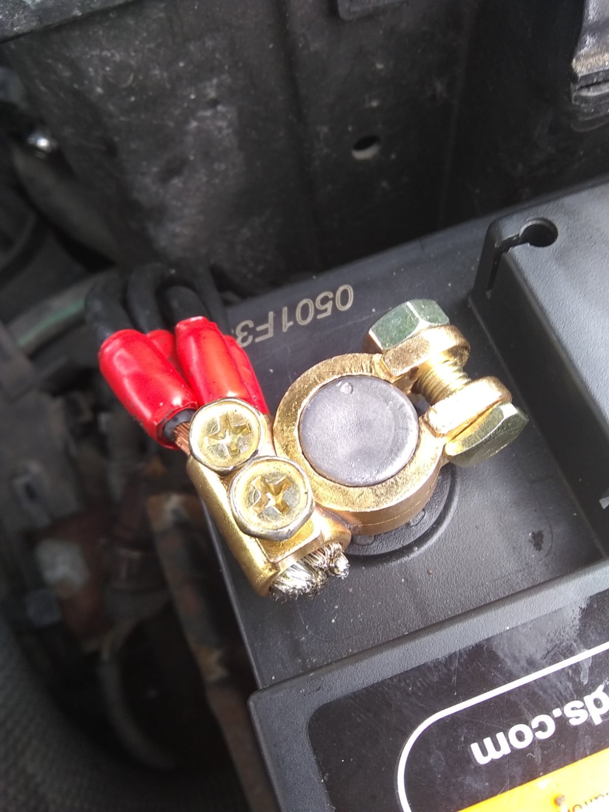

Re: Xantia immobiliser issue
Did some wiring today
