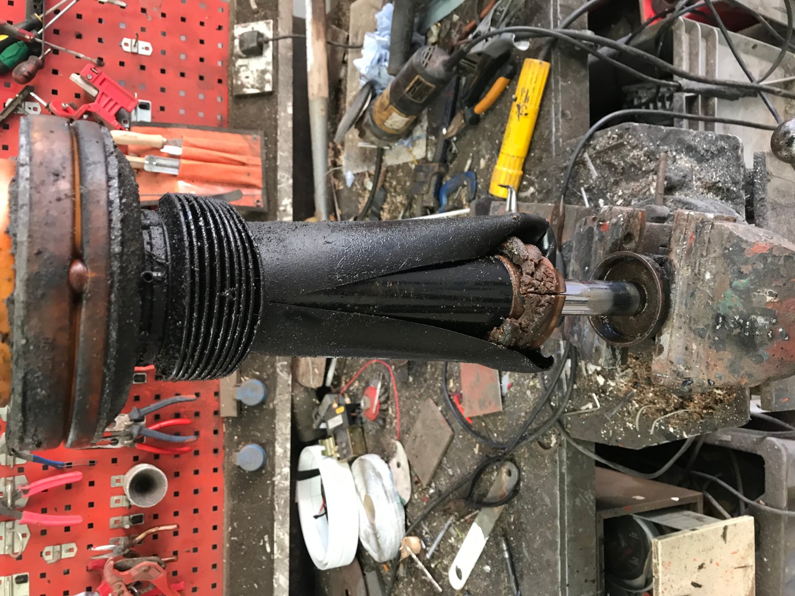

For some time now my X7 has been suffering from an issue on the passenger side strut whereby the gaiter had come loose from the bottom section of the strut, and was stuck around half way up the 'ram' section. After trying nearly everything to pull the gaiter down back into the cup at the bottom of the strut, and not having any luck, I resigned myself to having to live with it... knowing that the strut was on its way out and would need changing soon.
Well 'soon' came last week when there was a huge fluid leak all over the drive and the strut was done for.

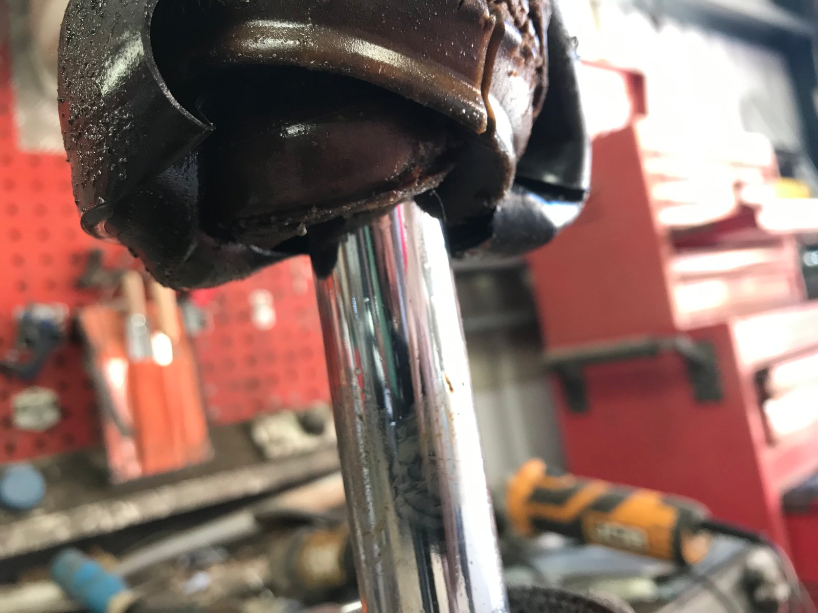

Here we can see the state of the strut just after the catastrophic failure: Here is the strut just after removal: I then took a blade to the gaiter to have a look at the failed seal:
from the looks of it, the main seal on the strut seems to have failed catastrophically and expanded somehow?

Yeah, that's what i thought! The seal has properly failed. I've already done the replacement with a brand-new strut which has a revised part number; hopefully this one will last longer.
The car has done about 77,000 miles to date. I think I damaged the front struts some time ago by driving over a set of raised level crossings in France at speed after the suspension pump had failed, meaning the car was riding really low. The car virtually took off then slammed down with a massive bang from the front end. I had already replaced the other front strut before this incident but hopefully that one survived undamaged.
