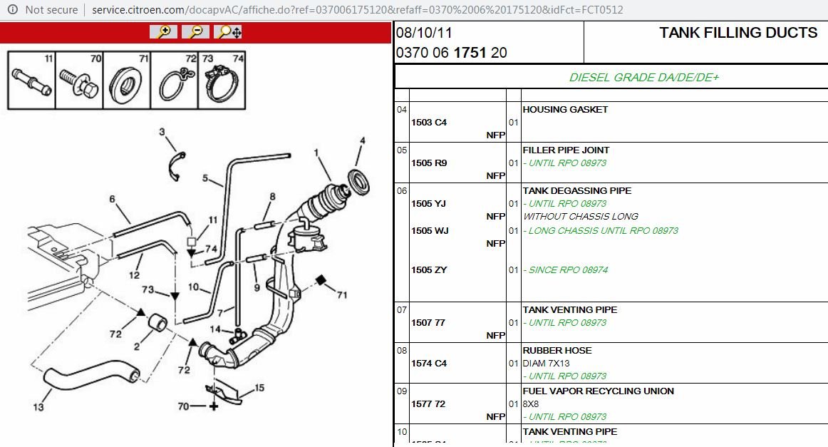

The large fuel filler pipe looks as if it enters the tank right at the bottom. Wonder whether that would allow a peek inside without removing everything?
Only a remote possibility. As you say, you might just have to burrow in there. Broken or wrong pick-up unit fitted??

Doesn't look like it's sagged inwards, you're right about the filler pipe. My tank's almost empty (I think...) so I'll disconnect that tomorrow and see what I can see in there

I then removed that pipe from the tank, and out poured some fuel:
Given that pipe isn't the lowest point, and that the pickup is in the centre, where the lowest point is, I think it's safe to say there's still fuel in the tank that it can't get to
I tried taking a look inside but couldn't see much. I also tried shoving my reversing camera in there so I could see round the corner, but it wouldn't fit
