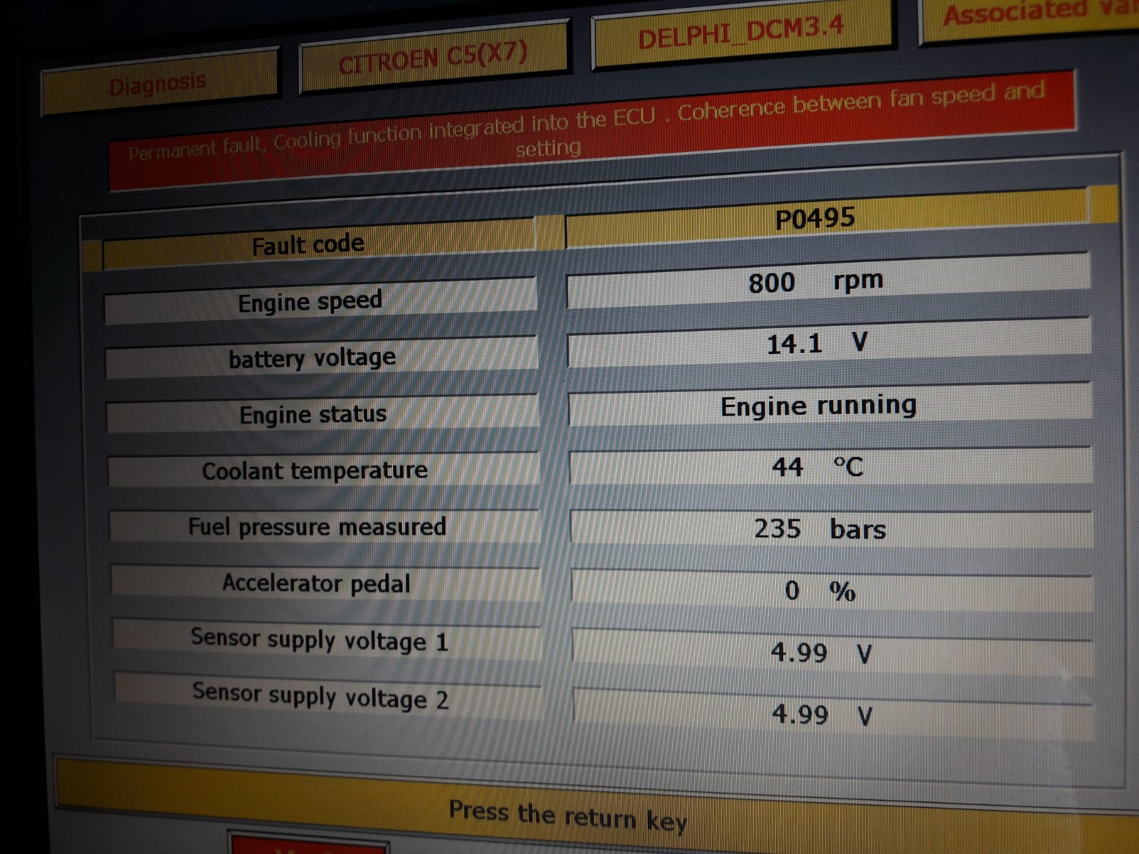

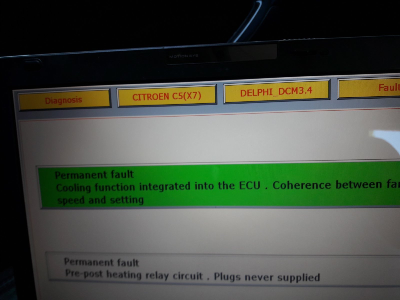

Having arrived at our house in the Dordogne and plugged into the Lexia, it shows a fault in the Injection Section - 'Permanent Fault - Cooling function integrated into the ECU. Coherence between fan speed and setting.' The fault code is P0495.
The engine fan, whilst free to rotate, does not kick in when the air con switch is pressed. Maybe there is a sensor or some other controller which is failing to turn the engine fan on, so that the air con shuts down? - the supply voltage of 4.99v shown in the one screenshot seems low? And where is this sensor? Or maybe the fan itself has failed, or a fuse, or what? Aaaaaargh! - in this heat the car is unusable.

| Engine ECU DELPHI DCM3.4 | |
| Fault code | P0495 |
| After sales description of the fault code | Cooling Function Incorporated in the ECU ( electric cooling fan unit) : Coherence between cooling fan fast speed and the reference |
| Description of the diagnostics | The fan unit is controlled at low speed and the actual speed is not low speed or if the fan unit is not controlled but even so is engaged |
| Conditions of activation of the diagnostics | Consult the associated contexts for the Pcode forwarding conditions |
| Conditions of disappearance of the fault | Driving for 5 minutes |
| Down-grade modes if fault present | Air conditioning cut-off Reduction in the activation thresholds for the coolant temperature alert |
| Switching on of the warning lamp and/or warning message | - |
| Main customer complaints likely | - |
| Suspect areas | electric cooling fan unit |

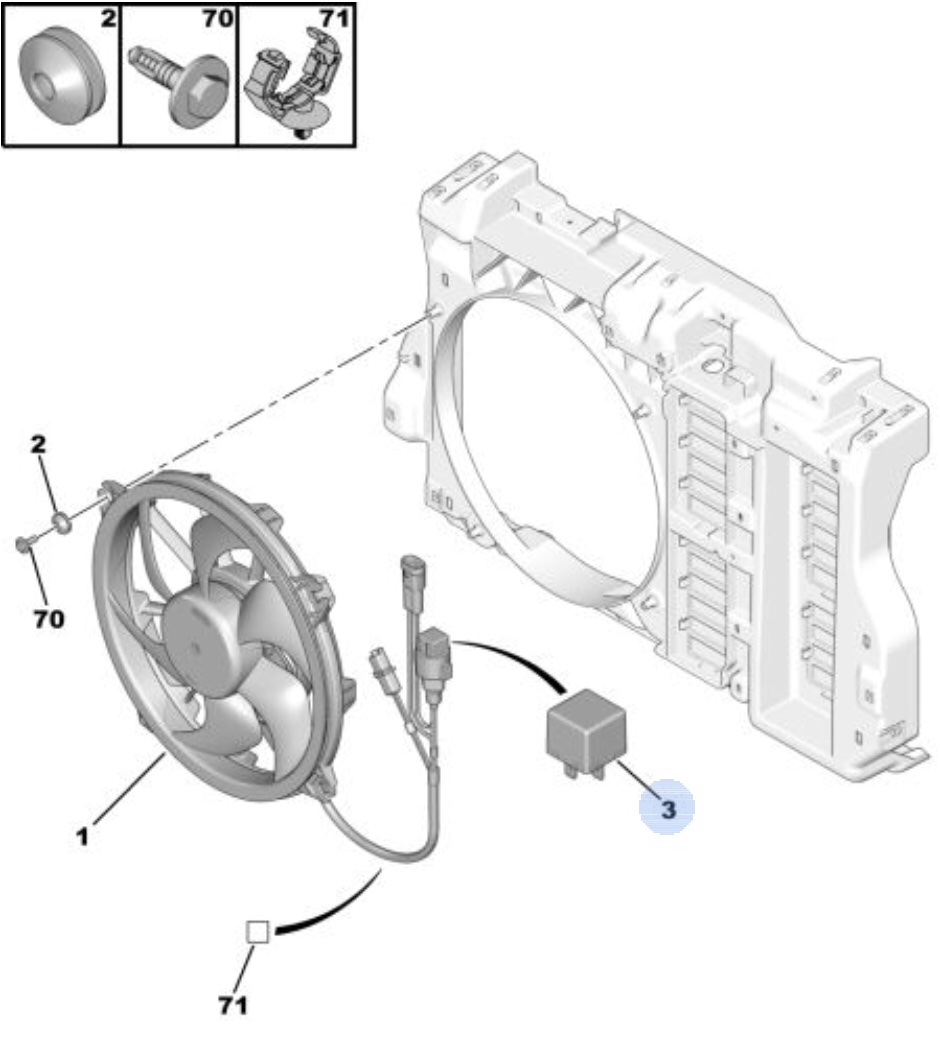

So I have had to take a few days off from trying to sort out this problem. Won't go into details but it involves a totally blocked outlet on the septic tank, so you probably don't want to know any more any way.
All I have managed to do so far is tonight, to perform an actuator test on the cooling fan with the Lexia. This came up as 'Impossible' on the lower speed and the higher speed would not kick in either. So It seems highly likely that the fan itself is defective or it's associated electronics. When I briefly tried the air con about 3 days ago the fan did start up and ran for about 1 minute. However it then stopped and the air con, which had started to cool everything down, shut off. Fault still shows as P0495.
I come back to my previous question - is there a relay in the line? - seems like there may be on in the wiring in the fan shroud. See pic. And is it part number 6545 XF? If it isn't that then it must be the fan itself which will be a lot more expensive.
- x 6947
Re: Air Con Failed x7 - just when I needed it
Yes that is the relay, 50 Amp Pete, Number 3.

Thanks Marc. I have now removed the relay and it seems ok. So next out was the fan which would appear to be the culprit. Could you please confirm the part number for me. Mine is different to the photo I posted - the relay and associated socket wiring etc are in a vertical box with cover alongside the fan. Looking at the new prices for a fan I may have to get a second hand one if I can track one down here in France.

Hi Pete, the part you want for the fan assembly is: 1253T3, (160W DIAM MAX 415). These are £486.77 inc. VAT from Citroen, but a selection on the bay:petef wrote: 09 Jul 2019, 14:15 Thanks Marc. I have now removed the relay and it seems ok. So next out was the fan which would appear to be the culprit. Could you please confirm the part number for me. Mine is different to the photo I posted - the relay and associated socket wiring etc are in a vertical box with cover alongside the fan. Looking at the new prices for a fan I may have to get a second hand one if I can track one down here in France.
