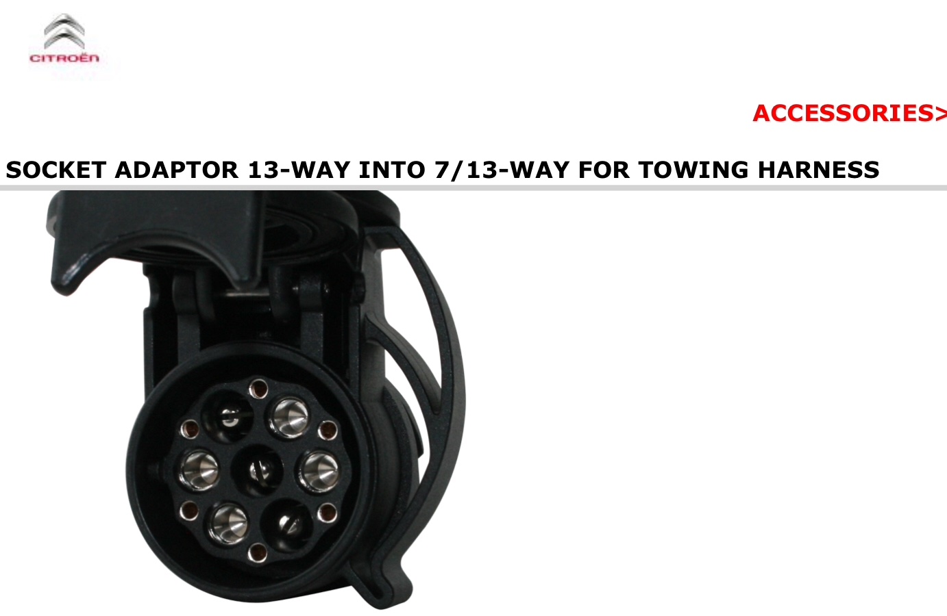

Hi Gerald, Citroen do a conversion adapter, is this what you need?

Hiya Marc, yes and no.
That adaptor is more of a halfway house. The 13 pin socket (when wired correctly), also includes a dedicated 12v auxiliary feed and can have a smart relay connected. I’m going to have to get into the wiring to do that.
