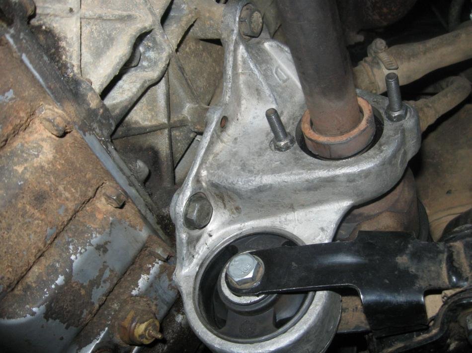

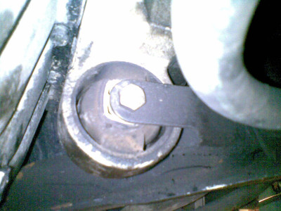

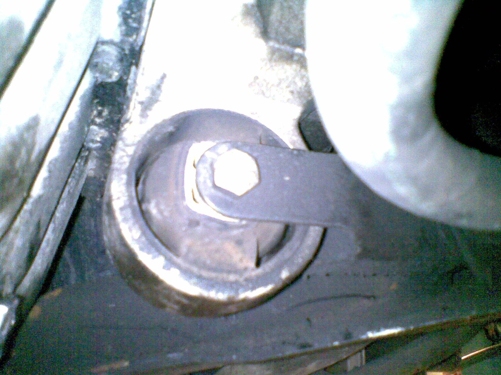

Do these images help ? I would press the bush in with the gaps facing the front and rear
Falconar12
Posts: 10
Joined: 13 Jan 2019, 08:14
x 2
Re: 406 rear lower engine mount bush position.
Unread post by Falconar12 »
Wow, great job. That shows me just what I need to know.
