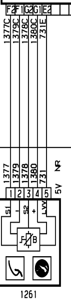

I am trying to trace my missing voltage from the Throttle Position Sensor -track 1.
Could I have some help please with the wiring of Intake Throttle Valve [1635 R8] and the Accelerator Pedal [1601 V8] to their termination at the ECU. I guess that's here they finish up!
[The ECU is the Valeo SW9664127180]

Ok, so the TPS (1261) has the following wiring and terminates in the engine ECU at the 48 Pin Black Connector (see Engine ECU corresponding pins at top of diagram F2 to E2): The TPS plug goes into the main harness 46 HAB, but you now know the Engine ECU pins from the TPS that are part of the 48 pin engine ECU connector.
The Air Intake Throttle Valve wires in the second diagram (1262) are shown below the picture and these terminate in the Engine ECU 32 pin Brown Connector, They disappear into Harness 20 MOT - and emerge again at the pins in the Engine ECU plug as shown.
| Throttle Position Sensor | Air Intake Throttle Valve |
| 1377 (White): Accelerator pedal 1 position info 1379 (Green): Accelerator pedal position earth 1378 (Beige): Accelerator pedal 2 position info 1380 (Purple): + 5 volt accelerator pedal position indicator power supply 731 (Red): Accelerator pedal point of resistance / signal | 1367 (Brown): Motorised Butterfly Potentiometer Earth 1218 (Yellow): Throttle Potentiometer Position Signal 1 1371 (Beige): Throttle Motor Command by + 1372 (Purple): Throttle Motor Command by - 1220 (Green): Throttle Potentiometer Supply 5V 1219 (Red): Throttle Potentiometer Position Signal 2 |

Exactly what I was looking for! Many thanks.
