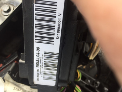

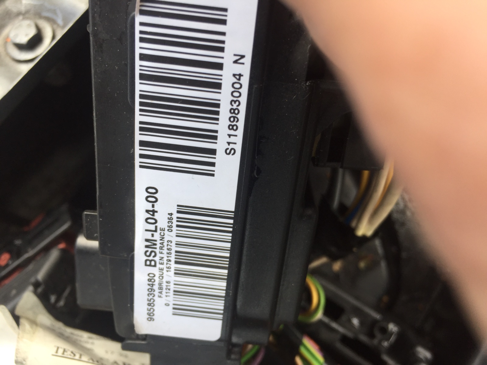

Richard w ...Citroen garage said 6500ck is part no. At nearly £300 ...hence why question as I can’t find a L04-00fuse box with 9658539480 or matching S number (see pic) . I can find 6500ck’s or with long number with 1or2 digits different but have same fuse & socket configuration !!! So your saying don’t buy anything without same number then?

IE
This model has a Q instead of N at end of s number?
Citroen Peugeot Fuse Box Body 6500CK BSM - L04 S118983004Q
Will this work
Will this work

If you are buying direct from Citroen, use the 6500CK number.
If you are buying second hand from the internet, make sure you have the matching 9658539480 number on the unit label. Ignore the other numbers. You can search using 6500CK, but make sure when you locate units to buy, that it has the same number as 9658539480. That’s all you need to know.
