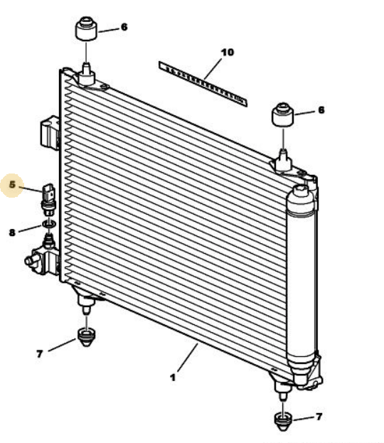

Aaah sorry, posting in the Aircon forum I tought it was obvious it's the Aircon pressure switch I'm looking for.. preferably the low pressure one, if there more switches?
The clutch magnet coil got 3.9ohm. And I've removed the shim so clutch gap seemed to be good now.
I got a loos fitting on the suction pipe on the compressor. The pipe is bendt due to a previous accident so I'm waiting for a new second hand pipe.
Meanwhile I would like to jump the low pressure switch just to check it makes the compressor to engage.
I have found a contact that goes to something on the compressor on the opposite (under)side of the clutch. Is that the sensor in looking for, or is that an overhearing/temperature sensor switch?

Re: Low pressure switch location C5 2006?
The only pressure switch (Aircon Fluid Pressure Switch or Dehydrator Pressure Switch) is item 5 below:
Thanx Mark!
Any ideas on what PSI that switch engages?
Here's some info on the system that may help you.
Management of the cooling compressor - Air conditioning compressor safety
Air conditioning evaporator icing safety function
To prevent icing up of the air conditioning evaporator, the BSI prohibits triggering of the air conditioning compressor in certain temperature conditions.
The evaporator icing up safety function is managed by the BSI.
In the table below: The air conditioning compressor is cut off, if the evaporator temperature sensor is less than a low limit for 1 minute.
The air conditioning compressor is retriggered, if the temperature returns above a high limit and the cut-off time of 1 minute has elapsed:
Cutting of the air conditioning compressor due to compressor speed
When the air conditioning compressor speed attains 8100 rpm the air conditioning compressor is cut off.
If the air conditioning compressor speed exceeds 7500 rpm for more than 10 seconds, the air conditioning compressor is cut off.
The triggering of the air conditioning compressor following a cut-off due to the speed depends on the air conditioning fluid
Air conditioning fluid pressure safety
The air conditioning high and low pressure safety management status is transmitted by the BSI 1 via a linear pressure sensor.
The linear pressure sensor measures the pressure of the air conditioning fluid.
The reception of pressure information is carried out by the engine ECU through a wire link.
When the pressure of the air conditioning fluid is below 2.8 bar, the air conditioning compressor is cut off. The air conditioning compressor is triggered again when the air conditioning fluid pressure increases to above 3.3 bar.
When the pressure of the air conditioning fluid is greater than 28,2 bars, the air conditioning compressor is cut off. The air conditioning compressor is triggered again when the air conditioning fluid pressure falls below 20 bars.
