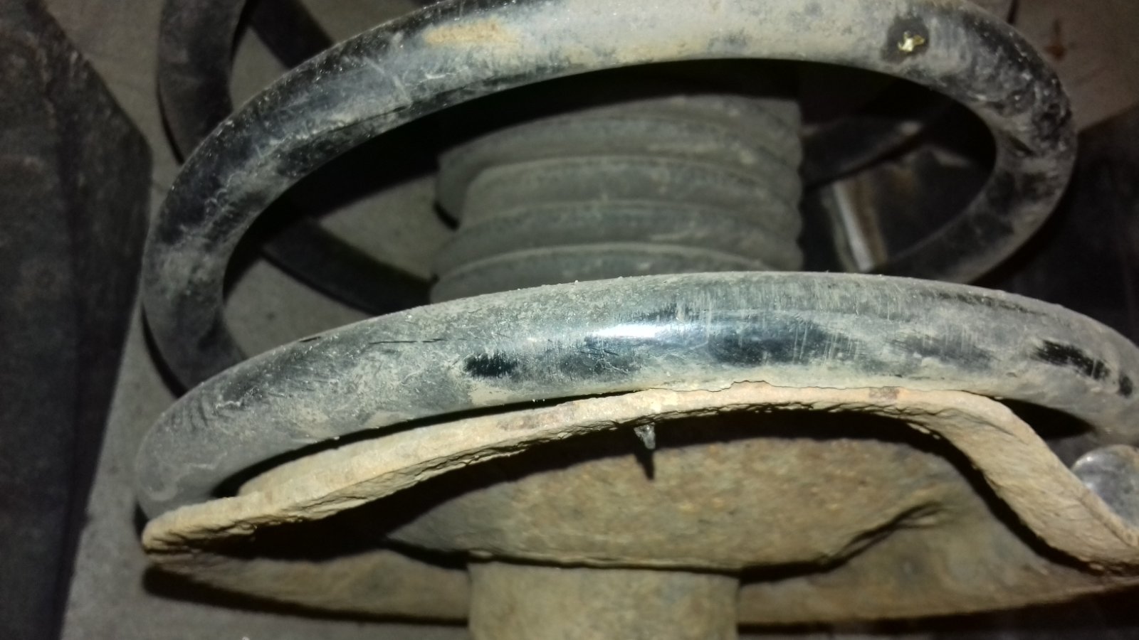

Have you got any pictures?
does yours have the "Safety" platform below spring? it clamps round strut sits below platform so if spring snaps don't go into the tyre!
Mines come loose so has been rattling at times so off to cut through bolts and replace with 2 nuts and bolts.

They look ok!
The platform goes below them so if spring breaks as has happened on them it stays within not venturing into the tyre!
