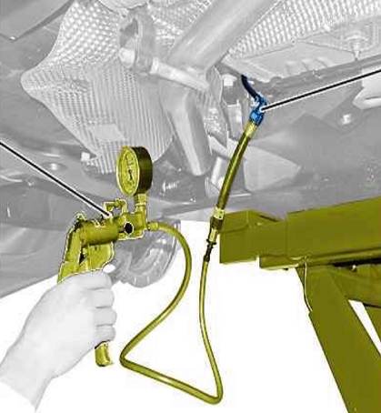

Thanks. I found a document that said to use a vacuum pump to check the additive pipe injector. Surely it meant a pressure pump as vacuum would suck on the pipe not blow down it.
- x 6945
Re: MOT fail.
The tool is shown below: This is a vacuum pump - but is connected as shown so that the vacuum is created in order to simulate the fluid being pulled back towards the fuel tank in the picture shown. It is not forcing pressure into the supply line, it is pulling. If it's showing 400 or less mbars then it's not blocked, but if it is higher than 400 mbars on the dial then it is blocked and hence no additive will be reaching the tank.
The unit capacity of the positive displacement metering pump is 6.45 mm3.
| Manual vacuum pump DA16 with adaptors | It's connected to the additive supply pipe shown |

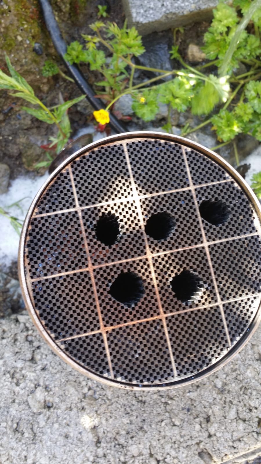

Ok so I cleaned off the sensors, and erased the error codes. Still smoking black on acceleration. I took off the DPF as the Lexia readings for last reg and distance between regens was zero. Particulation filter soot reading was zero. I took off the DPF and split, it was full of soot but see this...I suspect someone has been here before...... Will this cause excessive black smoke? I need to get it through an MOT as its already failed on smoke. How can I tell if the DPF is mapped out of the ECU - I dont get any DPF faults or EML on?
OnlineRichardW
- Posts: 12596
- x 1489
Re: MOT fail.
That'll do it.... No wonder it's not regenned - no diff pressure hence no signal to re-gen. If you fit a new DPF then it should get through the MOT - then you will need to see whether it will regen, and if not then we can start to work on why it's no regenning. Possibly the MAF faults are an indication....
