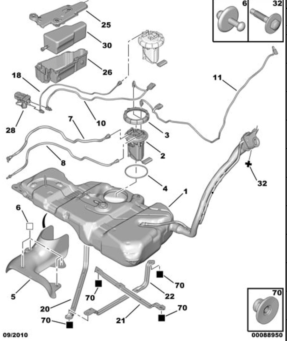

- Posts: 11837
- Joined: 28 Mar 2013, 21:05
- x 1996
Re: MOT fail.
It is a magnet "switch" that lives on the fuel filler pipe just below the filler hole. A bit of a pig to get the wires around the tank on the Mk1-2......not sure about the X7
Part No 20
Part No 20

Ok, so if open close the filler flap additive should be added. Is there a counter I can access via lexia to see if ECU see's flap open and close?
- x 6945
Re: MOT fail.
This isn’t an X7, it’s a C4GP.
No it doesn’t rely on this alone. It has to determine whether any fuel has been added or not. It is a combination of detecting the fuel cap being opened and also measuring whether fuel has been added from the previous quantity or not. But there would also be a fault code if the plug detect harness was faulty.
Sometimes the additive pouch (if replaced recently) may not be operating or may need to be primed.
This is the correct diagram for your vehicle:
