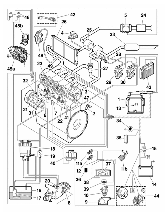

The speed control system is linked to the engine ECU. Under certain conditions, the injection ECU will disengage the Cruise Control and Speed Limiting functions as a safety precaution. This can happen when there are issues with the air or fuelling or when something is not right. Engine hesitation / jerking is one area where this would happen. So important to understand the route causes - as this can have a knock-on effect on other systems and trigger a fault that is not directly related.
In your case above, it would seem 2 faults are pointing to the EGR and one to the turbo. So I would get the air circuit checked.
The diagram below is actually for the DW10ATED engine for a C5 MK I (not the ATED4), but may be similar as it uses the same Bosch Injection System. Anyway it may help in identifying components.
If it is the vacuum supply, there may be insufficient vacuum to operate the valves, added to the age of the car with natural carbon build up which won't help.
On the Air Circuit Side:
(27) EGR Valve
(28) Turbo Waste Gate Control Valve
(29) Recycling Regulation Electrovalve (EGR)
(30) Turbocharging Pressure Regulation Solenoid Valve
(47) Vacuum Pump
(48) Throttle Housing Control Electrovalve
(49)Throttle Butterfly Housing (EGR)
