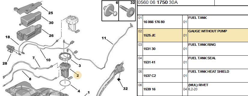

He doesn’t have an in-tank fuel pump, just a gauge sender unit in the tank on these.

Give me a break states that there is no in tank fuel pump. Can anyone confirm this please (not that I doubt his word) it's just that I've seen C4 Grand Picasso replacement in tank fuel pumps for sale.

Re: Car lost power accelerating then engine stopped. It won't start
The whole point of having your VIN is to confirm what I've already said - I'm not in the habit of guessing - you don't have an in tank fuel pump - only an in-tank gauge and if you need further proof look at the diagram lifted from your VIN and see item 2 and the description:
