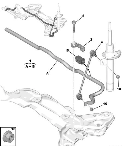

Ok, so just to confirm the official part numbers - BUT - there are 2 different types of driveshaft for the left and right hand sides. Eurocarparts are totally useless on a good day and I note they do not show the 2 different options! They only show one part. So I would be a bit dubious about that to start with.
Front right driveshaft is: 9801388680 or 3273WS for an exchange part from Citroen. Item 2 in the diagram. Item 1 is for the left hand side and that is part number 9801388580
Anti Roll Bar:
All that aside, you say you have "rebuilt the front corner". Has this been in a prang? Are you sure there wasn't any other structural damage if that's the case that is causing the misalignment?
Anti Roll Bar:
