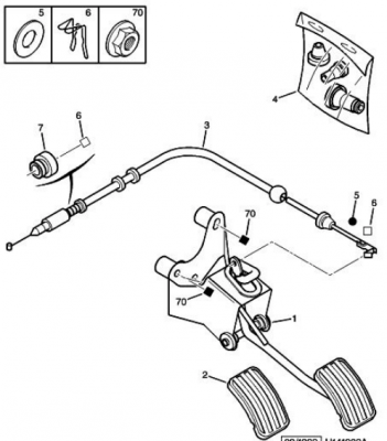

Here is a picture of the non-electrical pedal version - and as you can see has the wires you are describing. Unfortunately I don't have the diagram for this older version.

gmac please could you post the parts view and part numbers for the throttle pedal position sensor please, as there may have been a modified part. You have the lads vin etc.....thanks in advance.
thanks mark that looks just like the unit, the vdo one connected to the throttle pedal via a throttle cable.

| Mechanical Pedla Controlling Remote Version | Electronic Pedal Version |
Below is the Air / Fuel supply components:
(11) is the Accelerating Potentiometer (part number 1635Z9)
(14) is the Sensor - Accelerator Pedal (part number 1920X1)
