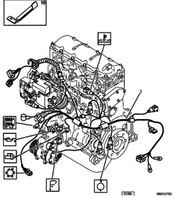

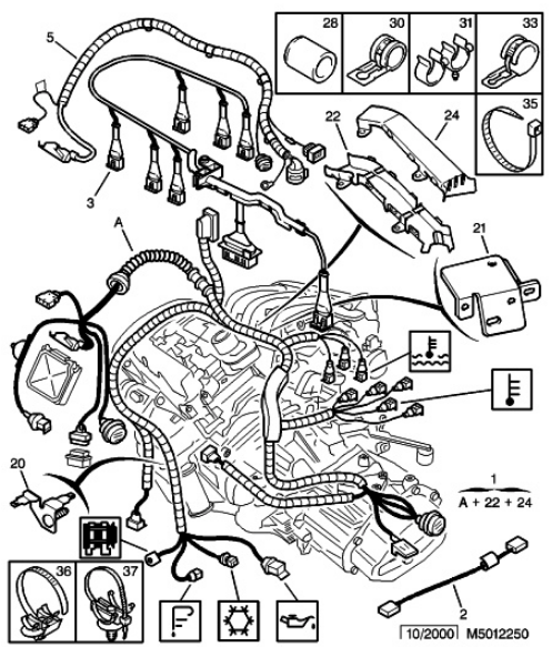

Any help? These are the engine wiring harnesses, depending on what electrical architecture you have. A VIN would narrow it down further.

Re: Mysterious connector in and faulty(?) ignition coil XM V6 ES9J4
Yes, i tried to pin point with VIN what it could be, but didn't really get far. All images just refer to "engine wiring", and do not mention that certain connector. Oh well, So i just assume it is what Xantia_v6 and stickyfinger told, because it doesn't affect how engine runs in any way.
