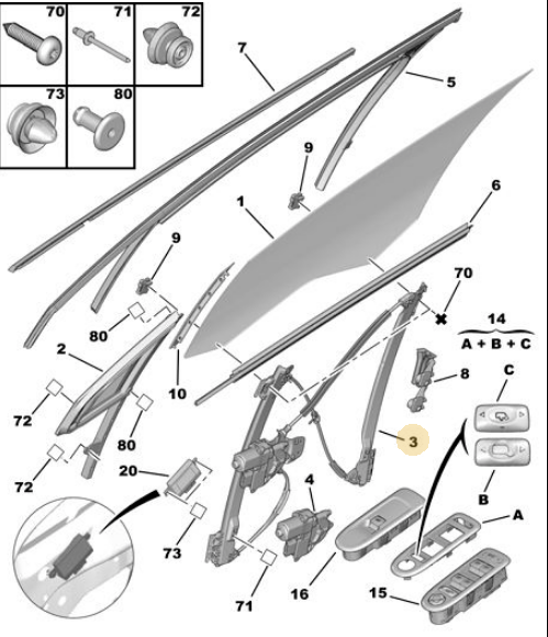

Re: C5 X7 Electric Window Stuck
Here you go, item 3
Original Part number: 9675898980 £412.46
or cheaper Citroen one - Part number: 1619991280 £119.75
With these part numbers, you can search for alternatives on the market if you prefer.
