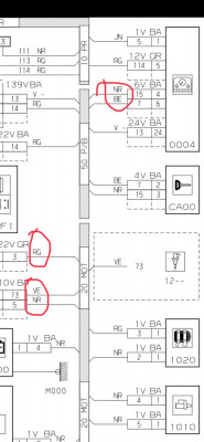

Hi all. Could anybody tell me what wires go in what holes on the four pin plug for the oxygen sensor on a MK1 Xantia V6 ? While trying to undo the plug so I can remove the sensor, I have mnaged to pull the plug off the wiring loom. So now I have four wires dangling down and I'm not sure which order they go in !
I have a wiring diagram but it only lists codes, not colours. :?
The wire colours are yellow, orange, green, and red
Any help greatly appreciated
Ian

I don't think that the colours are going to help, as Citroen seem not to have specified them.
I think that you are going to have to identify the 2 shielded signal wires that go to the ECU and the 2 heater wires that go to the fused supply and ground.
On the sensor, the polarity of the heater wires is not important, nor (as far as I am aware) is the polarity of the signal wires.

I have the diagram for the Xantia Mk1 ES9, but it does not show wire colours:
The Lamda sensor is item 1350.

If you have page 2 of that diagram above it should show the wire colours.
Are you not able to see the codes printed on the wires?

wheeler wrote: 14 May 2019, 07:24 If you have page 2 of that diagram above it should show the wire colours.
Here are the other 2 pages, but I don't think that they add much, no colours that I can see:

No doesn’t look like it in this case, on later PSA diagrams the second page normally shows the wire colour too.

As Mike said earlier, pins 3 & 4 are for the screened pair, so 1 & 2 are for the other pair.
Polarity of each likely not important.
Lord knows why cable colours seem missing from those diagrams; always present on earlier ones, and seem to be there later on as well.
Looking at your original photo, the wire colours just could be
red - green - orange - yellow/green
If they are that, they could be the same as this diagram (Gabor's, for XM) for ES9J4 V6 . . . #900 on the diagram
Might/might not help you to nail the connections.
[edit: diagram now corrected]

Re: Xantia V6 Lambada sensor wiring
Unread post by yannbeam »
Thanks for that. The Knowledge on this forum never fails to impress !
I wanted to check the feed/earth for the heater circuit but access is severely limited on the V6. She failed the MOT on emissions and I'm having trouble getting to the bottom of it.
