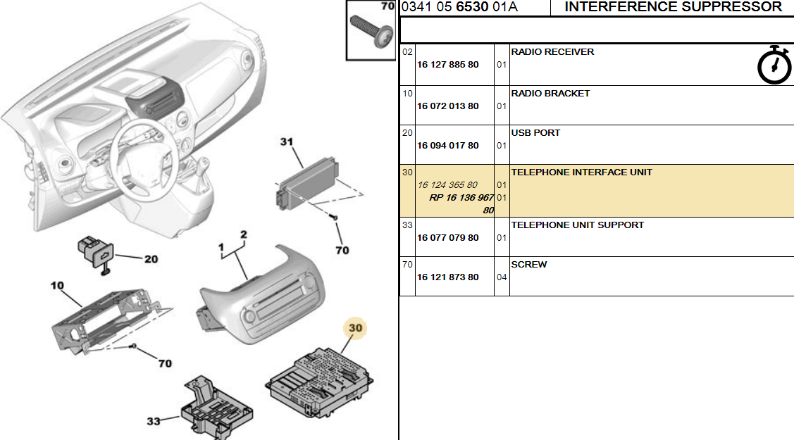

A BSI reset is common to PSA vehicles, but on FIAT based vehicles it is often used as well as a Proxy Alignment. It basically means one of the ECU modules is either mis/unconfigured or knackered. It is the Blue & Me system that is employed on this vehicle - an infotainment system for hands free calling and media playing etc. It is used on Chrysler Fiat vehicles and is called - wait for it - Windows Embedded Automotive :rofl2: Say no more. Although in the early days of the Xsara, they did flirt with the 'Auto PC' as it was called, which was based on the same Windows CE architecture and that was rapidly abandoned shortly afterwards.
However the partnership dumped this in favour of QNX (Research in Motion of Blackberry fame), which is used by Harman Becker Automotive systems as it is far more reliable.
The flashing mileage on these indicates a faulty module and is very likely to be the Blue & Me unit. The Proxy Alignment should detect any issues and reconfigure the module and pair it to the Body Control Module (BSI).
If you have tried a BSI reset, and you friend has checked the system out and done a Proxy Alignment, then the Blue & Me unit is probably duff.
On some Fiat / Alfa vehicles changing the driver door switch pack or replacing with another head unit (even the same model) will also cause this requiring re-coding. Very similar to Diagbox when you replace the Head Unit or another part that needs coding to the BSI on a PSA vehicle.
