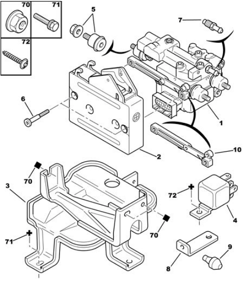

The RPO of this Xantia is 07015. All I can see about mods for the 1996 range from RPO 6748 to 7113 concerning the ABS is:
Replacing of ECU MOTOROLA by ECU ALCATEL.
The functioning of the 2 ECUs is extremely identical.
Interchangeability: The new parts are fitted in place of the old parts.
The ABS unit fitted is:
Part 4 was the Relay Mike was mentioning, part number 96131693.

Thanks for posting the VIN, which makes your RPO no.7015 (= mfg date of 23Jan1996).
The circuit diags I have (for XM, same system) suggest brake system is Teves 4, which includes that small separate relay (#4 in the Marc's diag above).
Function of the relay is to control the ABS dash warning light, including extinguising it, when the relay gets a command from the ABS ECU. (edited correction)
If the contacts (internal or external) of the relay are dirty or not functioning, the dash light will not operate properly. Dirt/corrosion is a known problem for relay sockets mounted "up front", where they get weathered. Check the relay contacts too; its cover can be popped off to get to the internals.
The relay is a "special" (it contains an additional diode) with an extra small base pin (30a) for connection to the dash light, and is Cit pt no 96 131 693, but NFP. The relay case has the circuit diag moulded into it. They don't usually fail, but do respond to a clean-up.
The operation of the relay can be observed by leaving its cover off, and watching the contact action as the IGN is turned on.

Thanks again. The diagram is excellent and I've been out to check. For the life of me I can't locate a relay anywhere near the ABS unit. Does anyone know its specific location? Is it perhaps one of the relays in the engine fuse/relay box just in front of the ABS unit? I'm quite happy to move the LHM tank out of the way a bit if it's tucked under it.

If you have a component location diagram the ABS Relay is #844.

I only have 1 mk1 Xantia diagram, which may be the Teves mk4, or may be the earlier system. It shows that the relay is inside the ABS block and has no direct connections to any external wiring.
Note that on the Xantia (unlike the XM) the ABS block is mounted high in the engine bay, next to the LHM tank, and is not subject to road spray. They very rarely fail, other than the early ECUs which I think were phased out by 1995.
It is more likely that the fault here is due to a wrong ABS sensor fitted, or a problem with a reluctor ring.

My wiring diags here all show Teves 4 having the external ABS relay.
The built-in relay shows as part of the later Teves mk20 system.

Not too difficult to replace with a standard 5-pin (changeover) relay, and add the additional diode and connection. The circuitry for this is clearly displayed on the relay case, including the polarity for the diode.
Alternatively, test the original relay and its diode, and repair as needed.
My guess is that it is a Green one, usual 1" cube.
