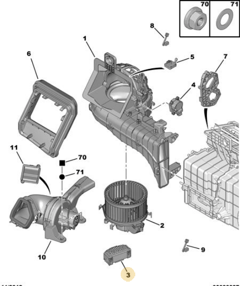

As for the parts - you only have the Heater Control Module item 3 on your vehicle (not item 11) which I think you've said you have checked as being fine. When these go, it is usually blowing full or nothing.

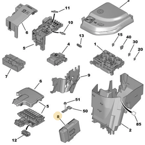

I'm afraid I can't help you with the relay location - it isn't shown specifically - but may be inside the relay box (Part 8) on the diagram below, which is usually located near the engine fuse box.
This should be what you are looking for - once you find it - use the wiring diagram to check the wires. There should be some wiring codes on the wire sleeve, so 8020 is shown on Pin 5. It is shown as having only 4 wires in the 5 pin relay. It could be there.
