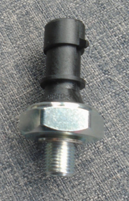

Taps and Dies
I need an M10x1 Tap to clean up some damaged threads where this oil pressure switch fits into the alloy cylinder head of one of my maintenance fleet.
The bog standard cheap sets never include this tap. An engineer friend of mine with a tremendous workshop, and a serious collection of motorbikes and cars opened up his beautifully organised little red cabinet of taps and dies and that size nowhere to be seen.
Put me onto "Tracy Tools" from Devon, and reckoned I would only need a cheaper one at around £5 for my purpose, and they were excellent at shipping and would sell the taps singly. I have had to look up wiki on Taps and Dies to understand the options of Taper Tap, Second Tap, and Plug Tap.

The stripped threads are on the female hole in the cylinder head so I need the male tap. Hoping I can get away with a clean up/recut of the threads, and coating the male threads of the Oil Pressure switch in a strong loctite formulation which be able to keep the joint oil tight. My friend also suggested dispensing with the supplied "washer" and using one with an inbuilt o-ring.white exec wrote: 27 Aug 2019, 21:30 If stuck, a standard nut (one of Gibbo's come highly recommended) can be used to clean up a thread.
