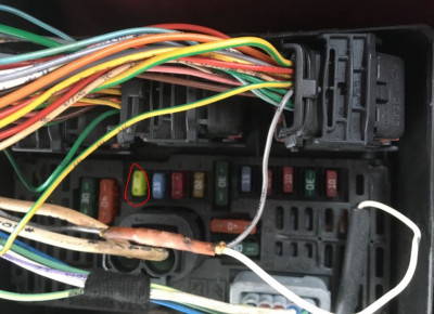

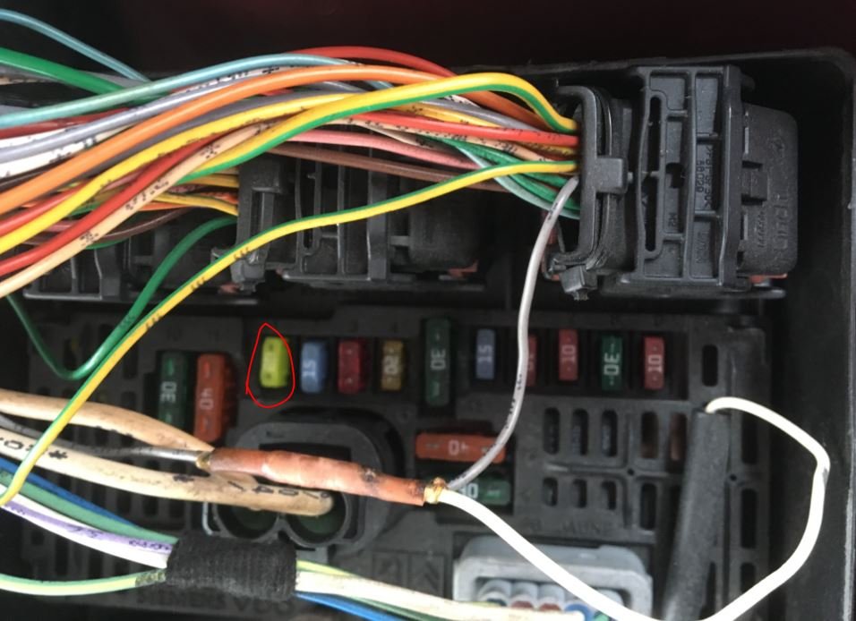

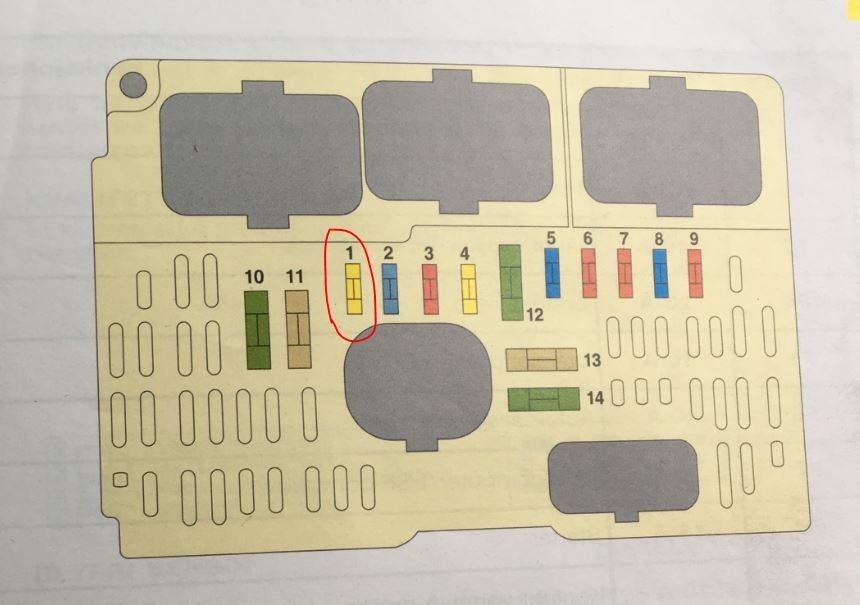

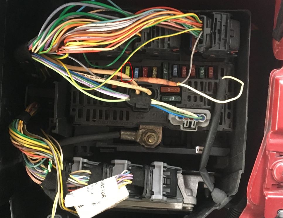

Later the day I started to check fuses and found one 20amp fuse gone, instruction book indicate the fuse goes to car computer and cooling fan.
When I replaced the fuse the engine started up on first attempt... I stopped the engine and tried again and i t started on first attempt...
The engine was only idling (I was not test driving the car) I got one error de-pollution fail (never seen these error before).
Later the day when I wanted to use the car, it was back to basic... start engine running (good speed), but the engine was not starting.
I was checking and the fuse was not gone these time...
I have tried to have the cooling fan on and off to see if there was any difference, maybe the fan has a earth fault?
But testing having the fan on or off has not given me any answer. When I turn the cooling fan inside the car on it will never start either with key switch of and on... maybe it was not running before either before the engine has started ? cannot remember...
What can the problem be? can it be that the car computer have a issue who shortcut the circle and took the fuse?
Why is it not happening again ? complete burn now ?
What can I do ?
Please see attached photos.

So fuse F1 (20A) is for the Engine ECU and the slow speed cooling fan relay. That's not same as the fan in the car, which is fuse F11 (40A) for the A/C and internal Fan.

1. I’m 99% sure no water was not coming in to the fuse box during the wash, the hudd was closed during washing.
