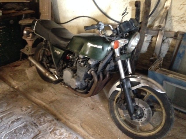

Following the purchase yesterday of a 1980 Z1000ST that hasn't moved for 10 years I need to add 2 very important items to the workshop shelf. Namely a degrippant, I've always used red diesel due to it's searching qualities, but I feel it may not cut it on this job. The other thing is a good contact cleaner.
Cheers all
Oh and does any know of a good resin for sealing the inside of fuel tanks, and what size of holes can it do, I've got one the size of a penny? I was thinking of taping the outside, pour the stuff in and swill, remove the tape and make good with a bit of P38 or whatever is used these days?
