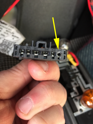

This is a picture of the right hand plug;
as you can see, it looks pretty normal.
Compare this to the left hand side;
You can see the earth pin is completely melted away!
