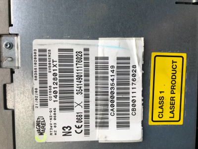

Oh and one other thing
Although we all decided it was an RT4 system, ok and behold, on the top of the radio unit - which I pulled out to disconnect the quad lock as recommended by Marc - was a sticker stating ..... RT3

Re: RT4 Screen problem
That’s perfectly normal, it’s an RT3 evolution, but it’s basically an RT4.

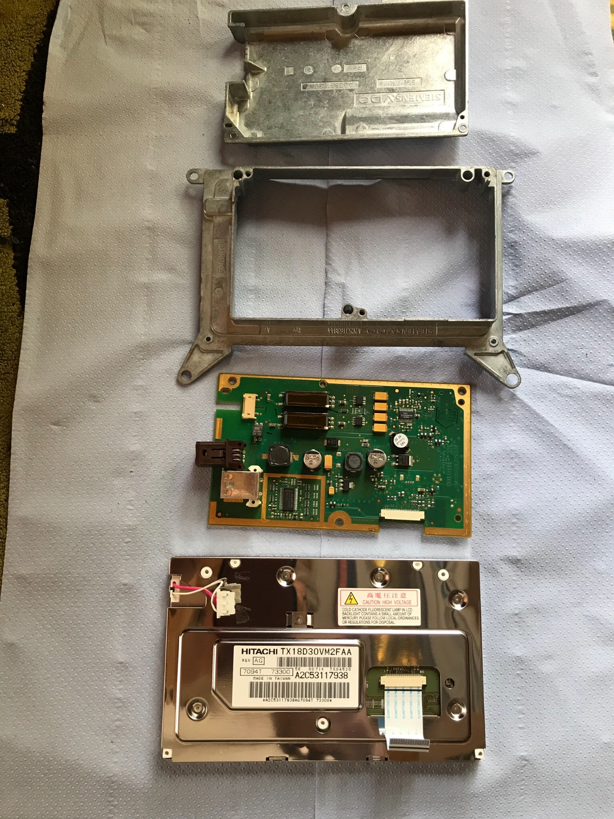

Ok, having fitted my nearly perfect display, I thought I’d dismantle my old one and this is what it looks like.
I’ve found several of the Hitachi TX18D30VM2FAA for sale but most are between £200 & £300
Vladimir, do you know of any that cost less than this ?
Cheers
Julian
Cheers
Julian
Hi Julian,
You did well with the display!
As I said, these "older" displays are more expensive than the DEVHR, which is a pity. The normal price for a new one is around 300-350USD, which is what you've already found.
Bare in mind that some of the eBay auctions have the "best offer" option, so you might try that and see how low you will get. Still, way lower than the PSA price.
Just a thought... Another option would be, as you are spending this amount anyway, to get a second hand hi-res DEVHR display for a picasso and then buy brand new matrix for around 70-80USD. At least you will have a very nice upgrade as the resolution makes a big difference, much nicer! You will have to do some telecoding to alter the settings in the head unit to suit the new resolution.
Here is such a display from a picasso (seems to me that the mounting is identical):
https://www.proxyparts.com/car-parts-st ... /10627802/
And here is the matrix I bought for 75USD including the postge from China:
https://www.ebay.co.uk/itm/LTA070B2U0F- ... 2749.l2649
Regards,
Vladimir
