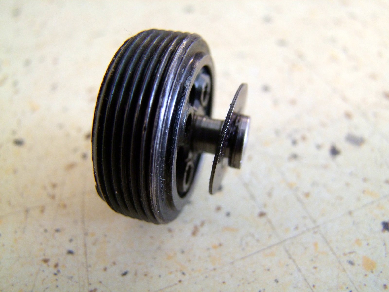

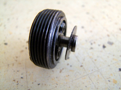

- x 1746
Re: Possible source for some hydraulic parts for Xantias
Good question, Simon.
The four large holes under the sprung washers would rarely (if ever) be opened "full bore", but just partially uncovered by the lifting of the washer(s) - so maybe the drilling in tbe adaptor isn't too bad?
Easy enough to enlarge, if anyone wanted to do that.

On the contrary, the washer valves would open on every large bump impact, as the large instantaneous flow rate would demand it - the centre bypass bore on a sphere damper valve (even the regular non-hydractive type) only allows for that very slow rebound characteristic speed. If you push the suspension down and release, the movement speed as it rebounds to equilibrium again is the flow rate through the centre bore only. Any movement significantly more violent than that gentle rebound needs to flow through the washer valves.
The valves and sphere pressures are tuned so that the rebound force is too weak to open washer valves (so a slow, controlled rebound in either compression or extension directions through that centre bore) but that regular bumps are strong enough to open the washer valves slightly - and thus can be easily absorbed.
It's not that it would't work, but it would definitely affect the overall response of the sphere somewhat and may lessen the ability to absorb large bumps.

- x 1746
Yes, the washer-valves will open, but never more than slightly. Examined up close, the valve multiple washer stack is in reality an extremely rigid affair, never designed to be fully opened...Mandrake wrote: 20 Aug 2019, 06:35 On the contrary, the washer valves would open on every large bump impact, as the large instantaneous flow rate would demand it . . . Any movement significantly more violent than that gentle rebound needs to flow through the washer valves.
...but to be "cracked open", and then to spring back.
As such, they never operate fully open, as that would involve permanent upward deformation.

That stack of washers might seem extremely rigid to a curious fingernail or pocket screwdriver but keep in perspective the forces acting on it.
You have hundreds of kilograms of mass inertia of the car trying to hold the body in place, you hit a bump, the wheel moves and the body (mostly) doesn't, the suspension arm/piston diameter leverage applies hundreds of pounds of hydraulic force on..... a tiny little stack of spring washers which can be bent up with a small screwdriver, whose job it is to resist the rebound of the mass of 1/4 of the car body...
When you think about it it's quite incredible that a tiny valve that size can be such an effective shock absorber, especially when compared to a regular hydraulic strut shock absorber.
To get the best balance of ride softness and stability through damping you want the threshold valves to not open for rebound (in either direction, since you can get rebound from a dip just as you can from a bump) so that the rebound is forced to flow slowly only through that small bypass hole, but to open for bumps, even modest ones, so that they can be absorbed.
That's in fact how most hydraulic Citroen's are tuned from the factory, and I think this is somewhat unique among cars and only made possible thanks to the very soft spring rate of the suspension compared to regular suspension, and I think is a good part of what gives a Hydraulic Citroen that rather unique damping feel that most other cars don't have.

I agree with your description, Simon, but the fact remains that the washer valves never "open fully", in the sense that the large flow holes (two in each direction) are unrestrictedly open as if the washers were not there. They may crack open by a good few degrees (no idea by how much exactly) but never anything even approaching 45°, or they would surely become permanently bent.
Given that - the holes never operating "fully open", the drilling in the adaptor doesn't look too restricting.
