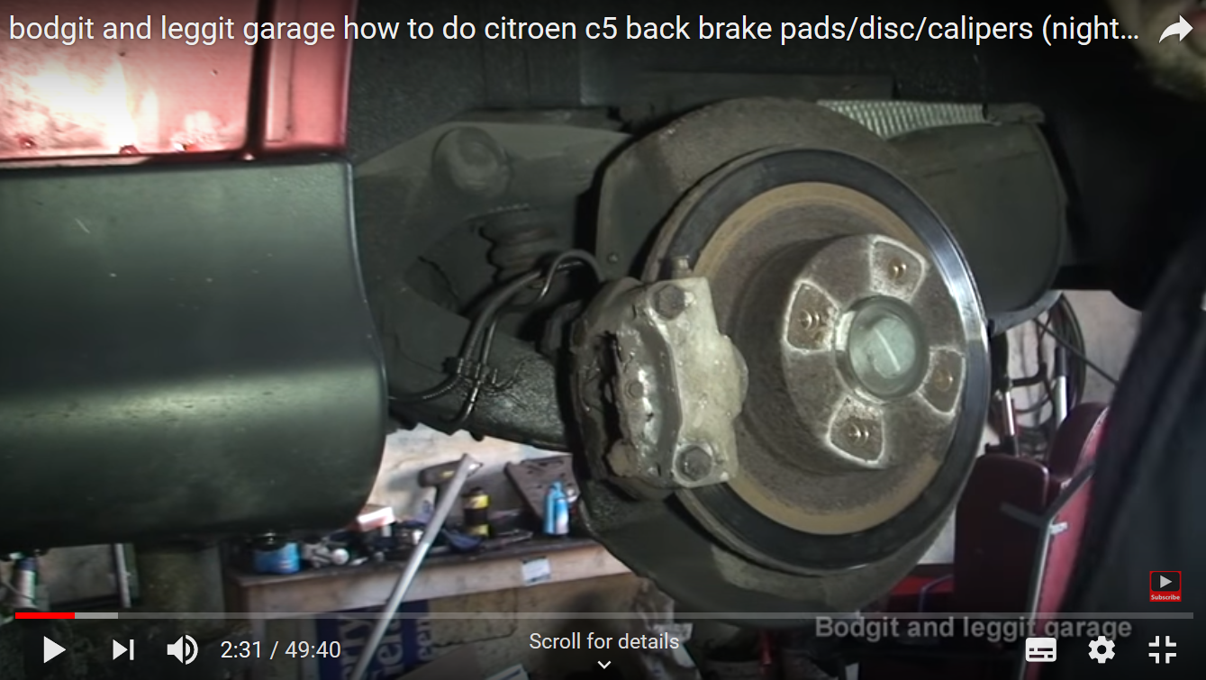

I have found videos from Autodoc on their youtube channel pretty good, but I hesitate to put up the one on changing the front brakes on a C5 because it got such a slating for not covering some of the key points, albeit it does give a clear idea of the scope of the job, tools needed etc.
The Youtube video is probably my first point of call to see whats involved in a job, but just like the printed Haynes manuals we all grew up with, they are by no means infallable!

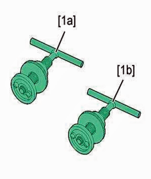

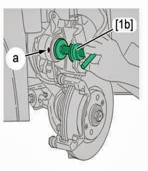

| [1a] Tool for retracting front brake pistons 8603 T.D ( right hand side). [1b] Tool for retracting front brake pistons 8603 T.G (left side). | Remove Raise the vehicle and support on axle stands, wheels free. Remove the front wheels. Disconnect the wear warning wires (1). Uncouple the parking brake cable (2) from the caliper. |
| Remove bolts (3). Open the clip (4). Remove the brake pads. Cleaning Clean the disc and the brake caliper using a recommended brake cleaning product. Allow to dry and to drain. Wipe with a paper towel. | The arrow "a" indicates the direction of rotation of the brake piston. CAUTION: To push back the front brake caliper pistons, the directions of rotation on the right-hand side and left-hand side are different.

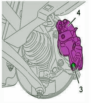

Fit the brake pads.
Push back the caliper (4).
CAUTION: Make sure that the locating lug engages into the notch of the piston.
Refit bolt (3).
Tighten the screw (3), after coating it with LOCTITE FRENETANCH, to 3,1 ± 0,1 m.daN.

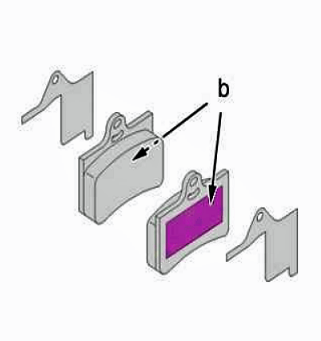

Coat the following zones with copper grease:

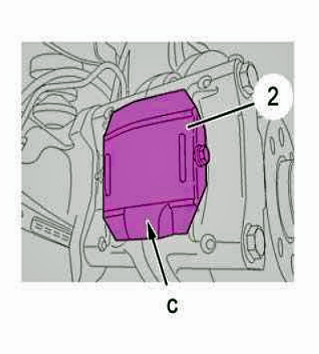

ESSENTIAL: No trace of grease, oil or lubricant can be tolerated on the brake pads. Fit:
| Fit the protection plate (2), with the scoop "c" pointing downwards. Tighten the nut (1) to 0,35 m.daN. Start the engine. Depress the brake pedal several times. Check that the brakes operate correctly. Refit the rear wheels. Return the vehicle to its wheels. Tighten the wheel bolts |
