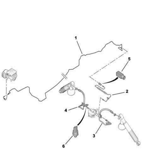

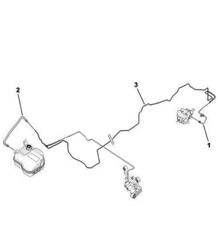

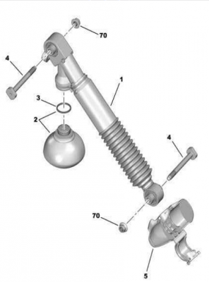

Ok, so here is the rear strut, the Rear Supply Piping and the Rear Return Piping:
You can see the pipe (1) Oil Back Harness on the last picture above is connected to the Rear Suspension Rigidity Regulator identified on the diagram below marked (2):
So that is how the oil gets returned to the BHI - via this single pipe.
| Rear Strut | Rear Supply Piping | Rear Return Piping |

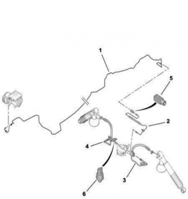

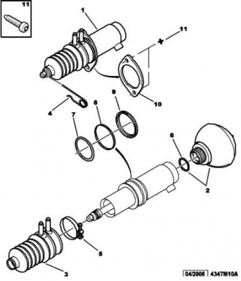

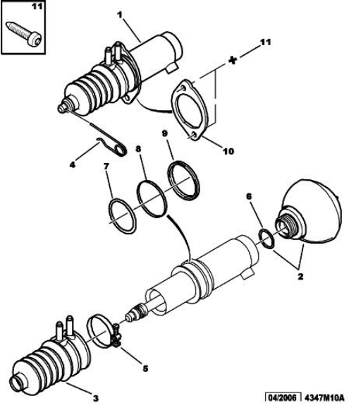

There are no leak back pipes from the gaiters on the X7. It's a different system than the MK I and MK II
If you have a leak from the strut - then it's likely you need a new strut. These struts are non repairable - they have bonded rubber to the metal strut. A horrible design. There are no strut seals or spares - its a whole new strut. Many of us have already had a front one go.
See on the picture below - this is a MK II design - plenty of seals, gaiters and as you can see there is a leak back pipe from the gaiter (item 3) - there is no such device on the X7 as you can see from the strut picture I showed you in my previous post and no spares or seals - zilch. It's a complete replacement if it is leaking from the strut which is likely as it won't leak upwards to the strut. The only other place is the sphere - but that is highly unlikely too.
