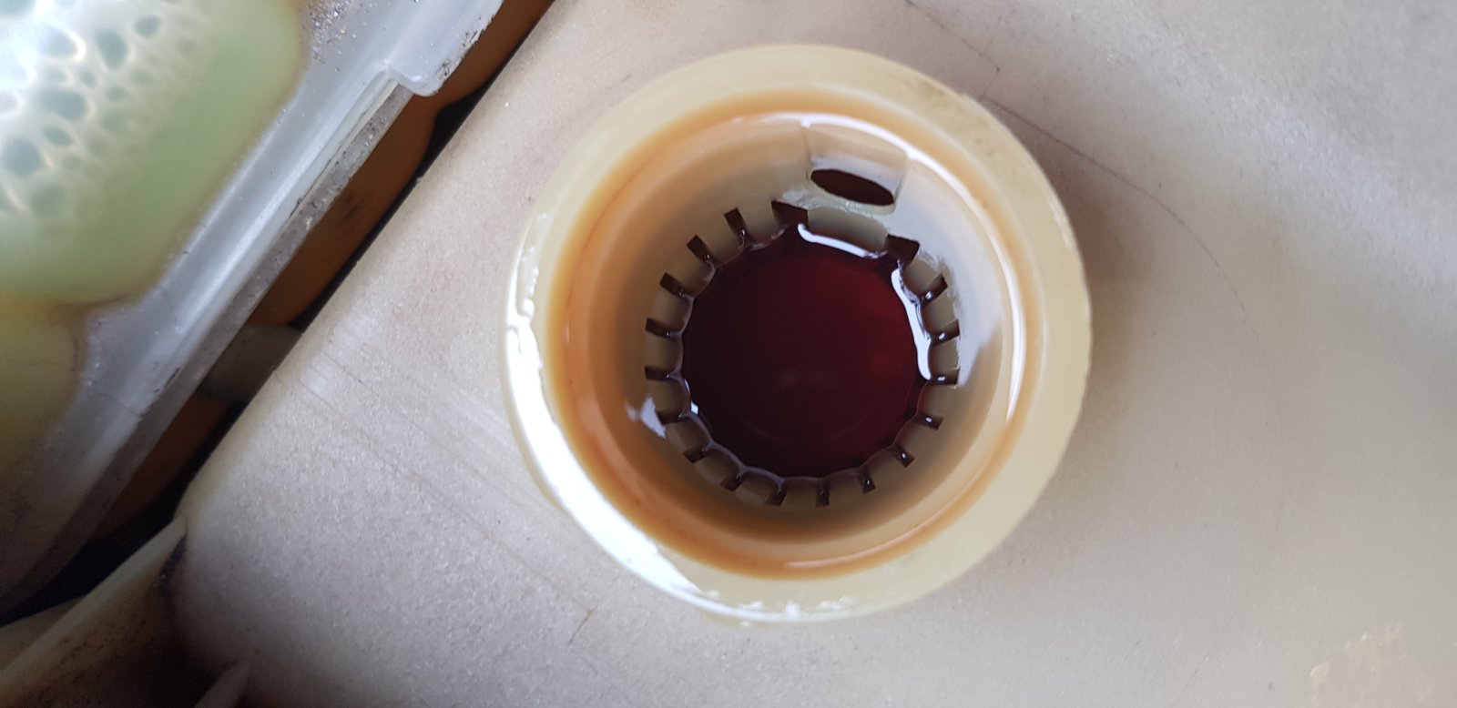

I encountered this error when I was driving with sports mode suspension settings. The only thing I did few days ago is top up LDS fluid.
When I checked the LDS reserve tank, the cap was fill with lds fluid and looks like it came out from tiny hole on top of the cap. LDS fluid is at Base level when on normal height.
Car drives normal but I go over speed hump it give this error message.
What could have cause this error message and is it safe to drive?

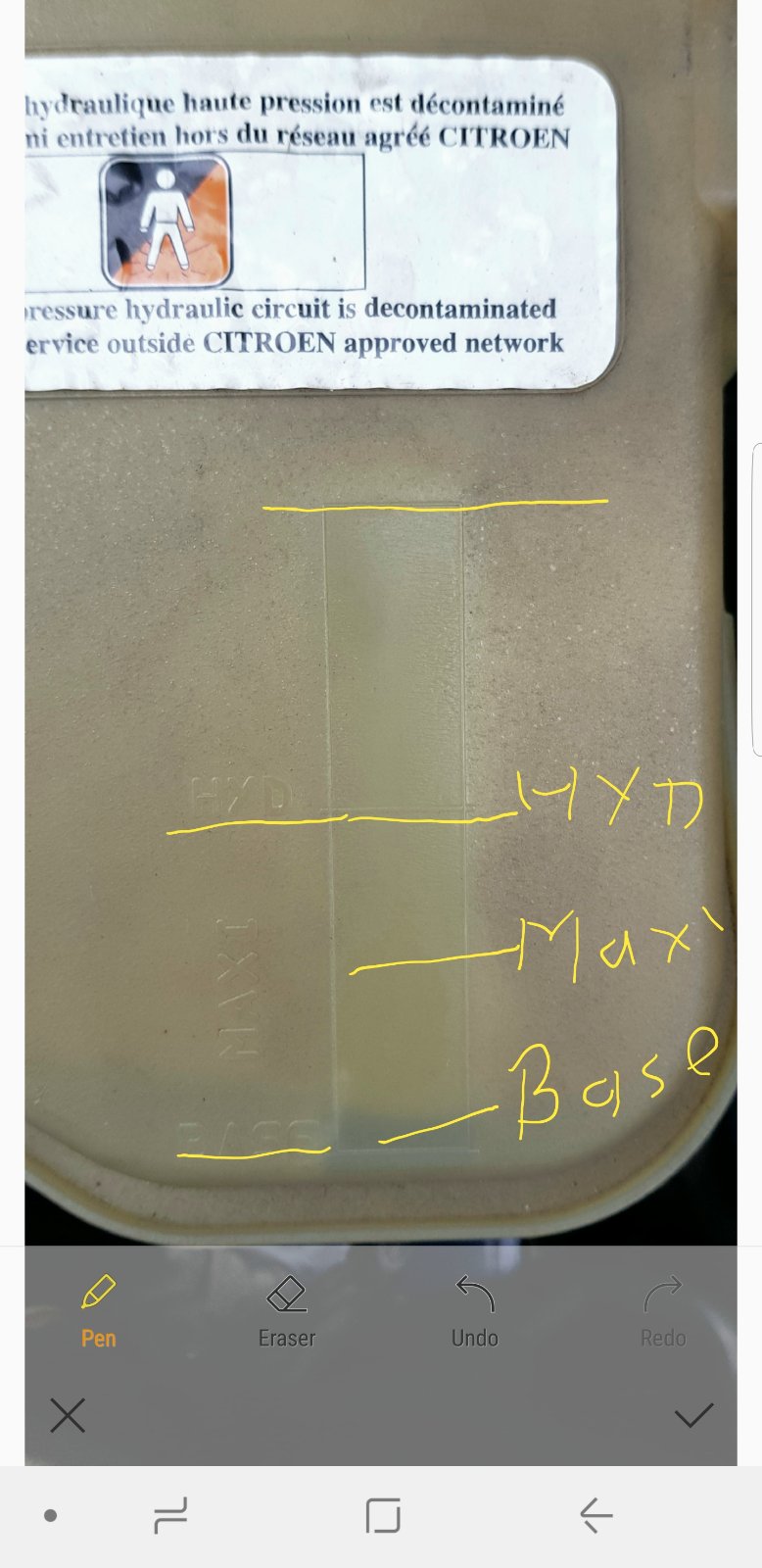

I empty around 100ml fluid to reduce the level. Don't know if it is still above the max limit. Attached photo s are after lowering the suspension to lowest.
When i remove the cap i don't see any pressure in the tank. Do i have to do anything with cap to maintain the pressure. When i checked the cap when error came up, it has couple of drops of oil came out from the pressure release hole.

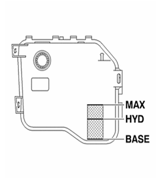

Ok, so you have a mark I and on early models there were 2 types of tank, the earlier one with a 'window' on the side of the LDS tank showing the levels as per the first diagram below and a later one where the levels are checked using the cap filler neck.
According to your build date, you may have the earlier type with the markings on the tank side.
So in call cases now, use the LDS filler cap neck to check the levels, as per the instructions in the table, using the second diagram.

Older C5 MK I LDS Tank Refer to second diagram for checking levels. |
Old LDS Tank on early MK I C5

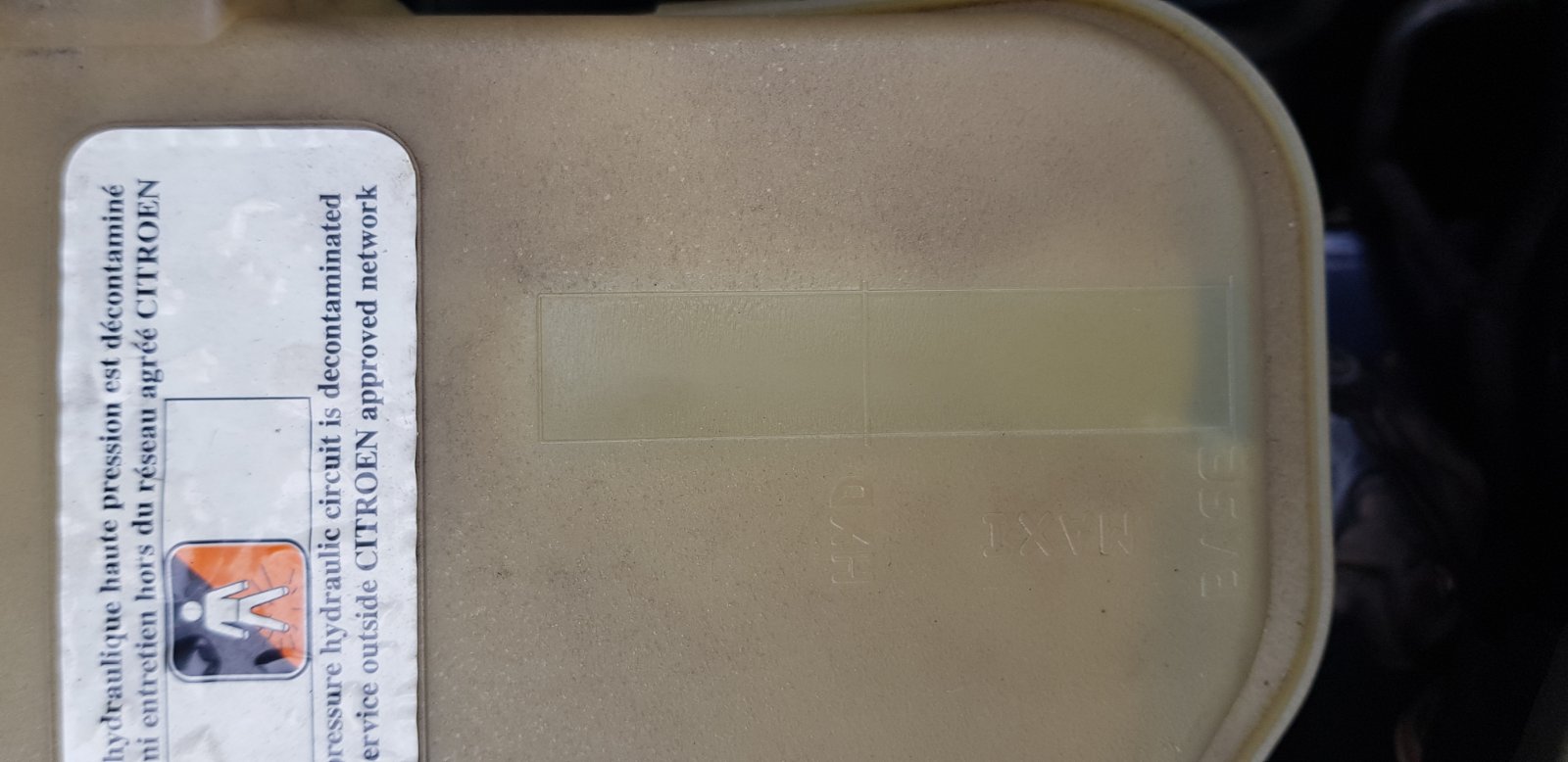

Mine has mark on the side of the tank as shown in the picture. If i fill up to base then it is 10mm above b. So dont know what is maxi and hyd levels are.
I drew car with and without sports mode over the speed humps and no error defected. I will monitor few days and see if the error comes up.
Thanks.a lot for quick response, much appreciated.

No problem, leave it at 'a' on the second picture again checked on lowest setting. Normally Lexia would be used to depressurise the hydraulic circuit and the levels properly checked when the car is fully depressurised. Ignore the older markings on your tank and focus on the second diagram.

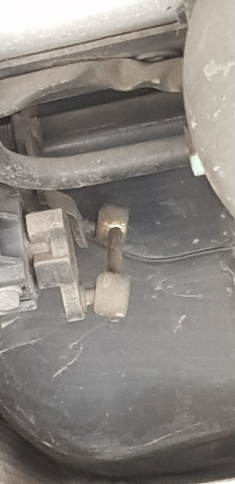

Error come back. After parking the car the rear suspension was higher than front. Tried lowering height but it gave error message similar to when it reach max/min and can’t lower. Drew the car in this condition at 60km/h without any fault. Parked the car and was able to lower and raise the car with no error. Could it be height corrector issue or the pump.
Thanks

Height correctors for sure.
Check the linkage near the dog and bone of the heigh correctors but don't get underneath the car if you have not got it supported with axle stands as there is the likely possibility that it can rapidly lower and crush you.

Re: Serious Suspension Fault
It doesn't look too bad, but make sure it has some silicone oil around the moving parts - but it is possible that the internal tracks of the height corrector are worn.
Try raising and lowering the car several times to see if that cures it.
I applied Silicon lubricant, let see if this resolve the issue.
Thanks
